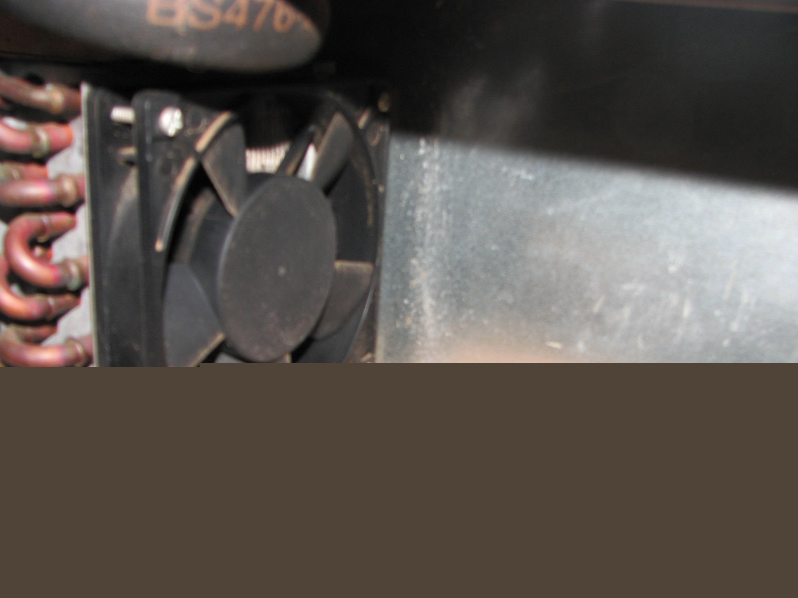

Glacier Bill Posted February 3, 2011 Report Posted February 3, 2011 Yes Phil, I did add a second fan. It's just a 100mm computer fan cost about $20, simple to fit don't even have to drill holes as the holes in the second fan match up with original fan frame. Just tap into pos and neg fridge feed wires and use a switch to turn off the second fan when required. Have added a photo (if it works) not very computer savy.Regards Bill. Quote

Glacier Bill Posted February 4, 2011 Report Posted February 4, 2011 Chris, Just install it the same way as the original, the second one is just to increase air flow through the cooling fins on the condenser. The air is drawn from the front of the condenser, through the fins towards the compressor. You will still have to defrost on a regular basis, especially if there is high humidity. You could wire up second fan to the original so the second fan will only run when original starts. I just leave our's on all the time and sometimes it is running when original fan is stopped, has been doing this for over 12 months now and seems ok. Before I installed the second fan the original never cut out, meaning it was struggling to cope with the cooling in hot weather. You need to blow out the condenser fins with compressed air now and then depending on the dust. We were working in the Territory last year and it was amazing the amount of dust that collected there. We have a small food thermometor hanging in the fridge and when the temp rises above 4-5 deg c we think about defrosting. We have found that these fridges don't work too well in hot weather if you open the door and leave it wide open even for a short time.Hope this helps,Bill. Quote

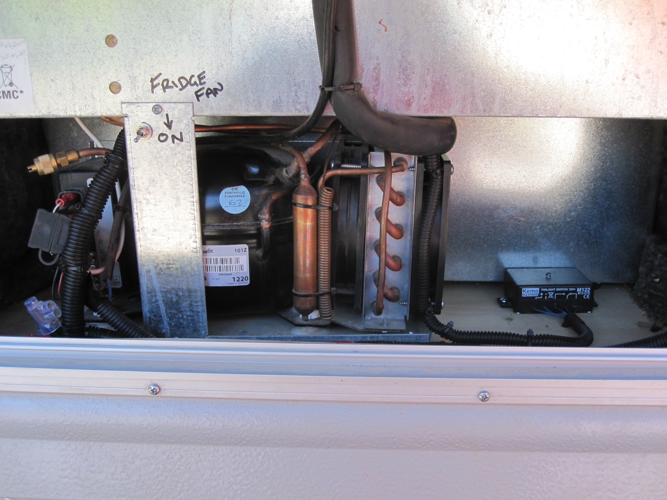

Webby Posted February 8, 2011 Report Posted February 8, 2011 We installed a separate fan which stands approximately 3-4 inches away from the original. This is operated by a separate switch inside the van. If the fridge looks like it is getting hot....or needs a bit of a boost, we just flick the switch inside and the temperature drops. Also good if the original fan goes and we're away from a service centre, we have the second fan that will get us by until we reach civilisation to have it replaced.Having said that, we have only "flicked the switch" twice as our fridge temperature is usually pretty good. Quote
