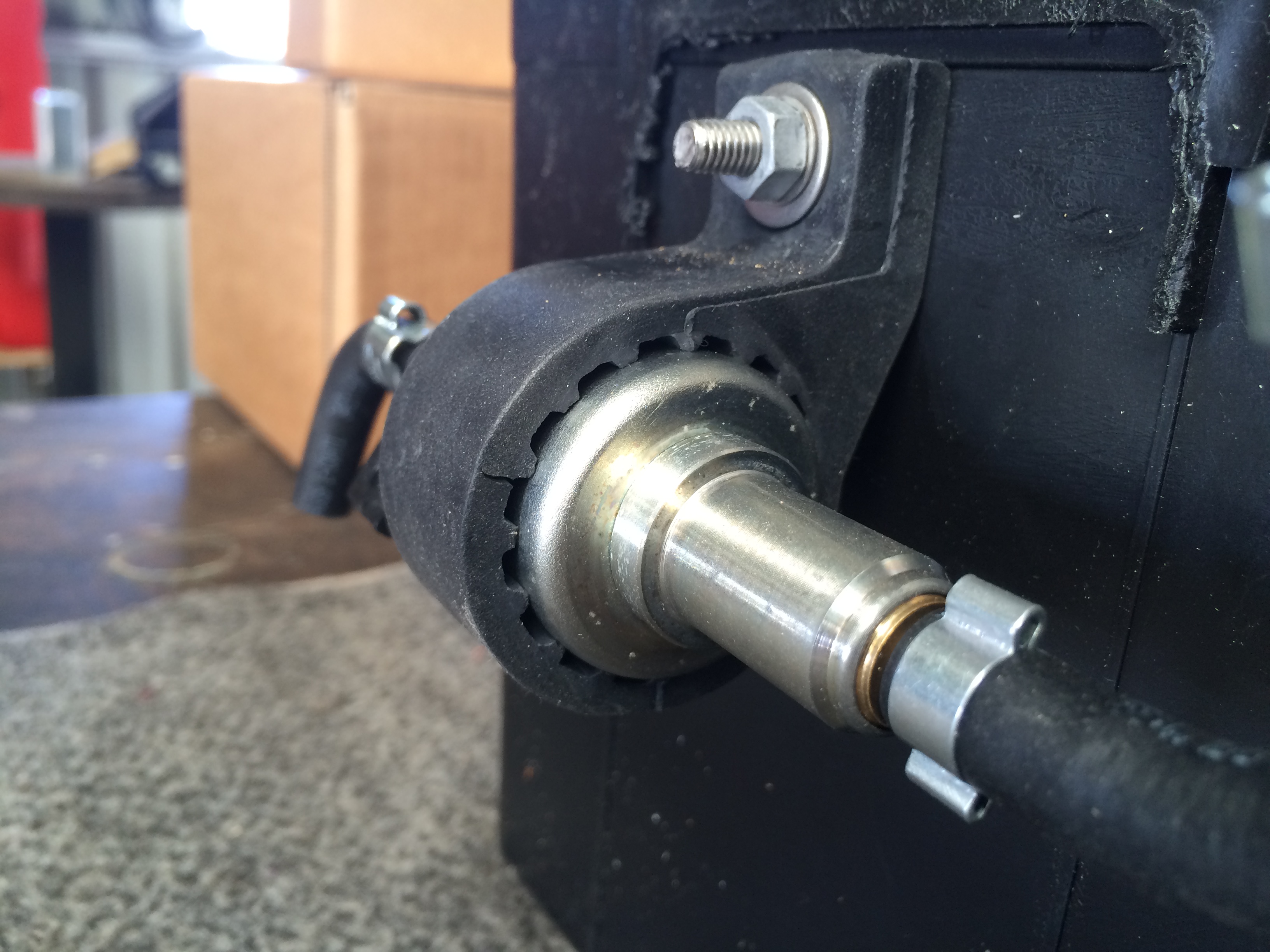

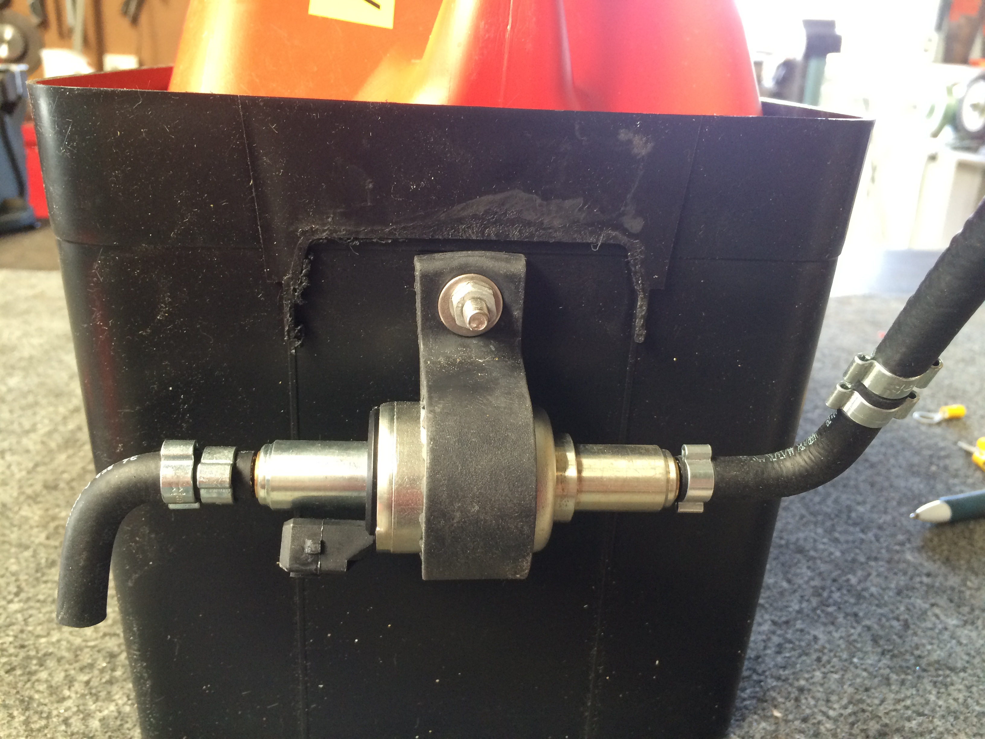

GraemeY 12 Posted October 4, 2014 Report Share Posted October 4, 2014 I came across this bulletin from Webasto about quieting the ticking noise from the heater fuel pumps , i tried it on our Top Ender and it made quite a difference to the noise level , see bulletin attached pump noise.tiffIt consists of 2 parts as rubber fuel pump mounting attachment fuel pump mount.tiffand 2 rubber 90 degree elbowsrubber hose.tiffI also insulated the fuel line hose with rubber so that the noise from the fuel pump wasn't transmitted through the fuel line to the chassis , make sure the fixing points are at least 200mm from both sides of the pump , some Kedrons may allreeady have the rubber pump mount on them The cost of the rubber mounts are $28 and the elbows are $7 each plus postage for more info give me a call 0418130971 email gyost@toolstas.com.au Quote Link to post Share on other sites

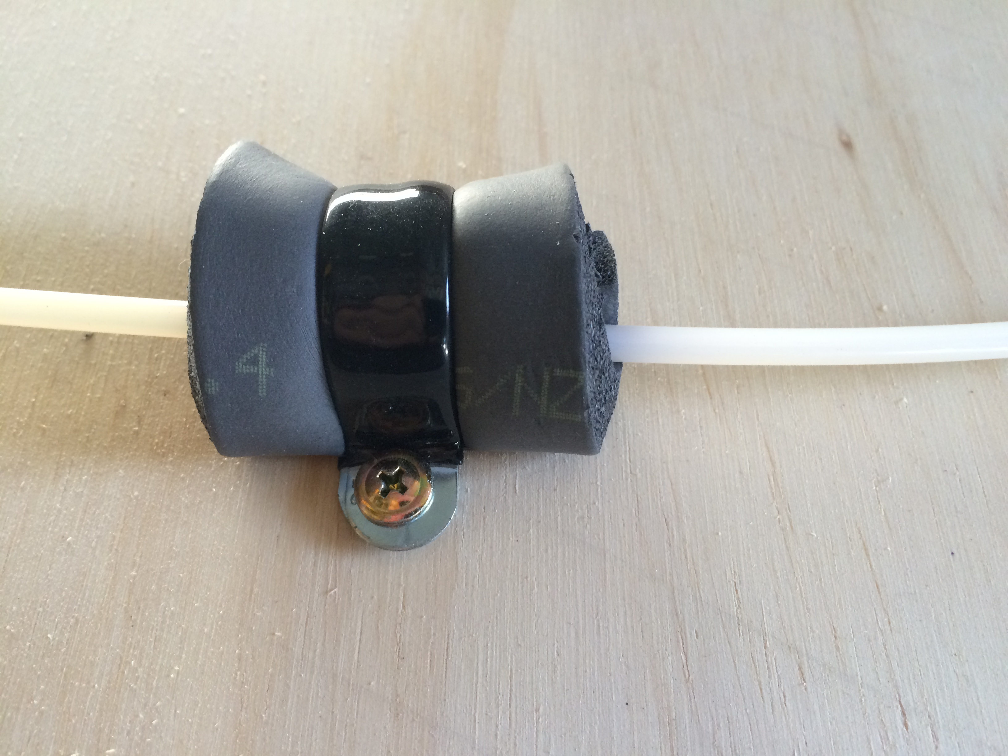

GraemeY 12 Posted October 25, 2014 Author Report Share Posted October 25, 2014 HI PeteThanks for the call the other day , a couple of things to do is firstly make sure any insulation you have put around the pump is not touching any metal , if it does it will transmit some noise through the chassis , check and see if you have one of the rubber mounts as shown in the picture , use 2 right angle rubber ends on the fuel pump inlet and outlet they need to be opposed in the direction ie 1 up 1 down see pic , also where the fuel line is attached to the chassis insulate with foam in a large p clip , i will attach some pictures so you get the idea , give me a call if you wish to discuss 0418 130971 Quote Link to post Share on other sites
