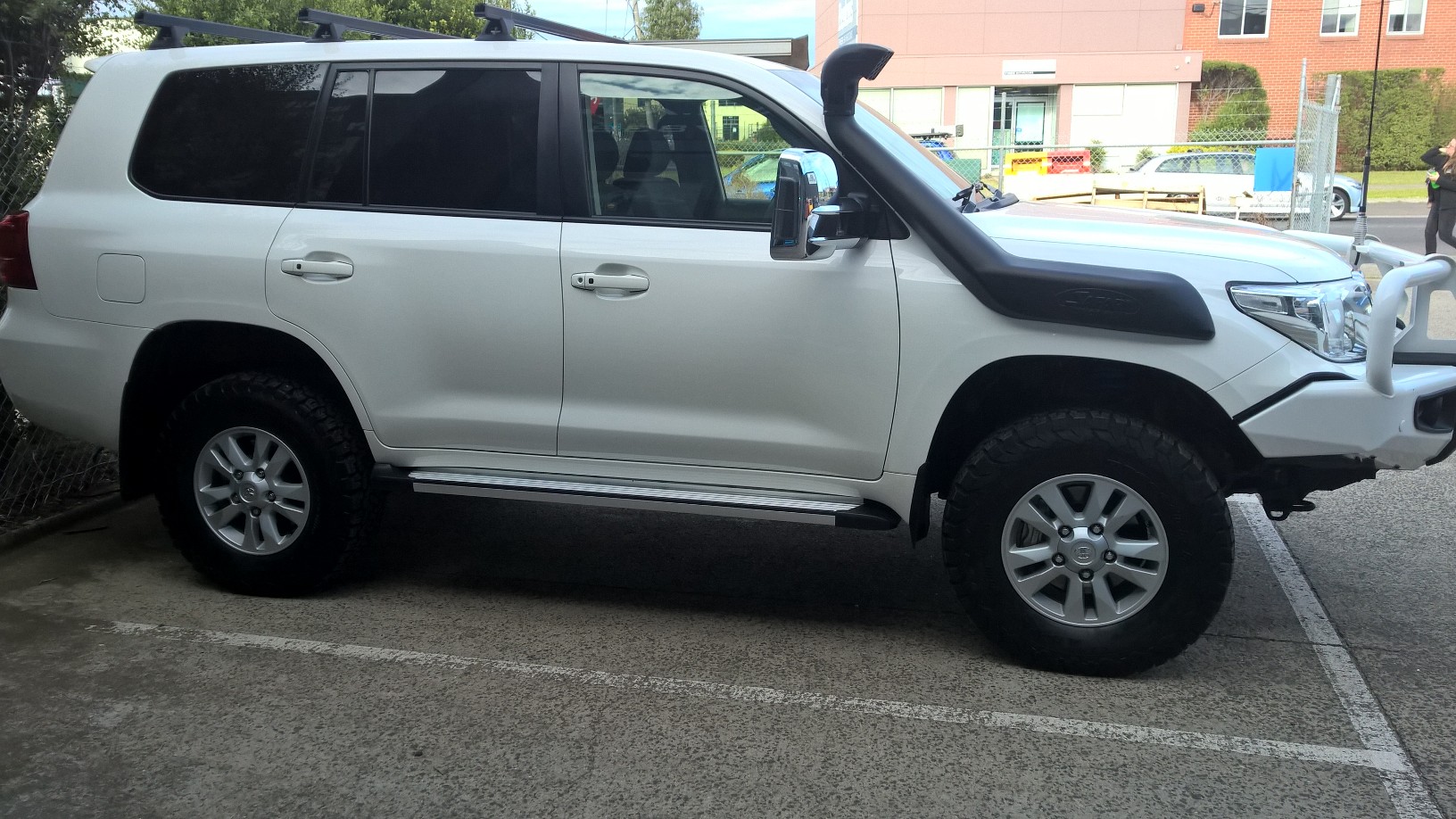

John and Tina 28 Posted April 21, 2016 Report Share Posted April 21, 2016 Attached is a photo of my 200 Series after a 3800 GVM upgrade from Lovells. I was left with no option but to have the upgrade carried out after a visit to the Weigh Bridge stated the weight of the vehicle at 3220 klg without caravan attached and other items carried in the car. The thought of changing to a GMC of F 250 did cross my mind however this was not practical for my every day use around town because of their bulk size. Had a trial run last weekend with the caravan in tow and handled perfectly not that the 200 series did not cope well before the upgrade. I am now looking forward to our departure in early June for a 3 months break. 1 Quote Link to post Share on other sites
