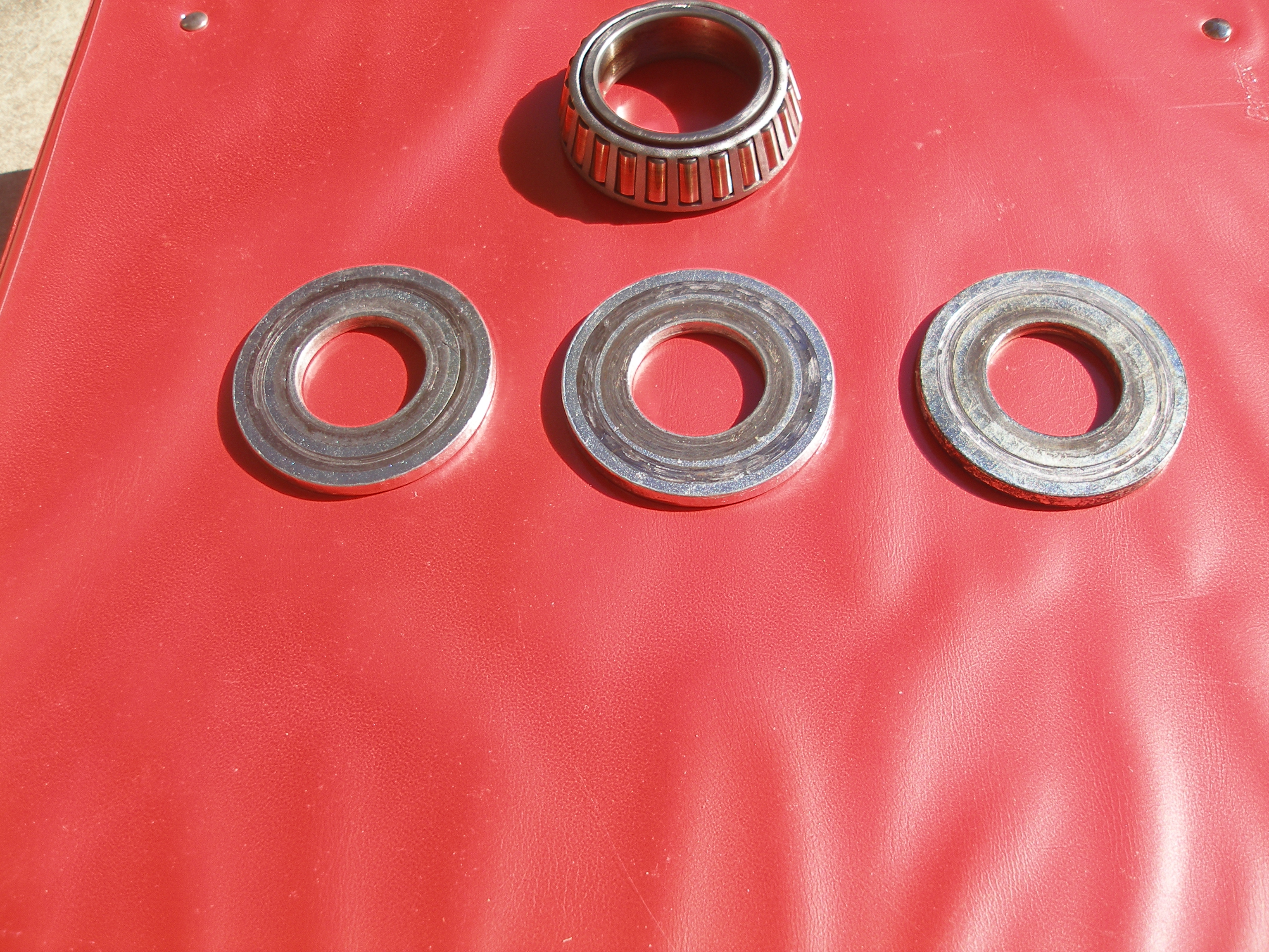

Axle Washer Tearing - Suggestions Please
I have been working in the wheel bearing and brakes department on our Kedron lately. Over some time I have noticed that the wheel washers holding the hub on the axle show signs of tearing on their inner or bearing surface. The tearing I believe leads contamination of the grease with small metal particles which quickly wrecks the outer bearing. I have just replaced two outer bearings which were showing marks on the bearing surfaces after only 5,500ks.
When towing I am always conscious of not attempting tight turns which puts colossal side thrust on wheel bearings and would "mark up" the soft washer surface.
On nut tightness I have always done them up moderately tight, then backed off, half to one flat to get the split pin in.
Does anyone have comment on how to manage this issue please, perhaps surface hardened washers?.

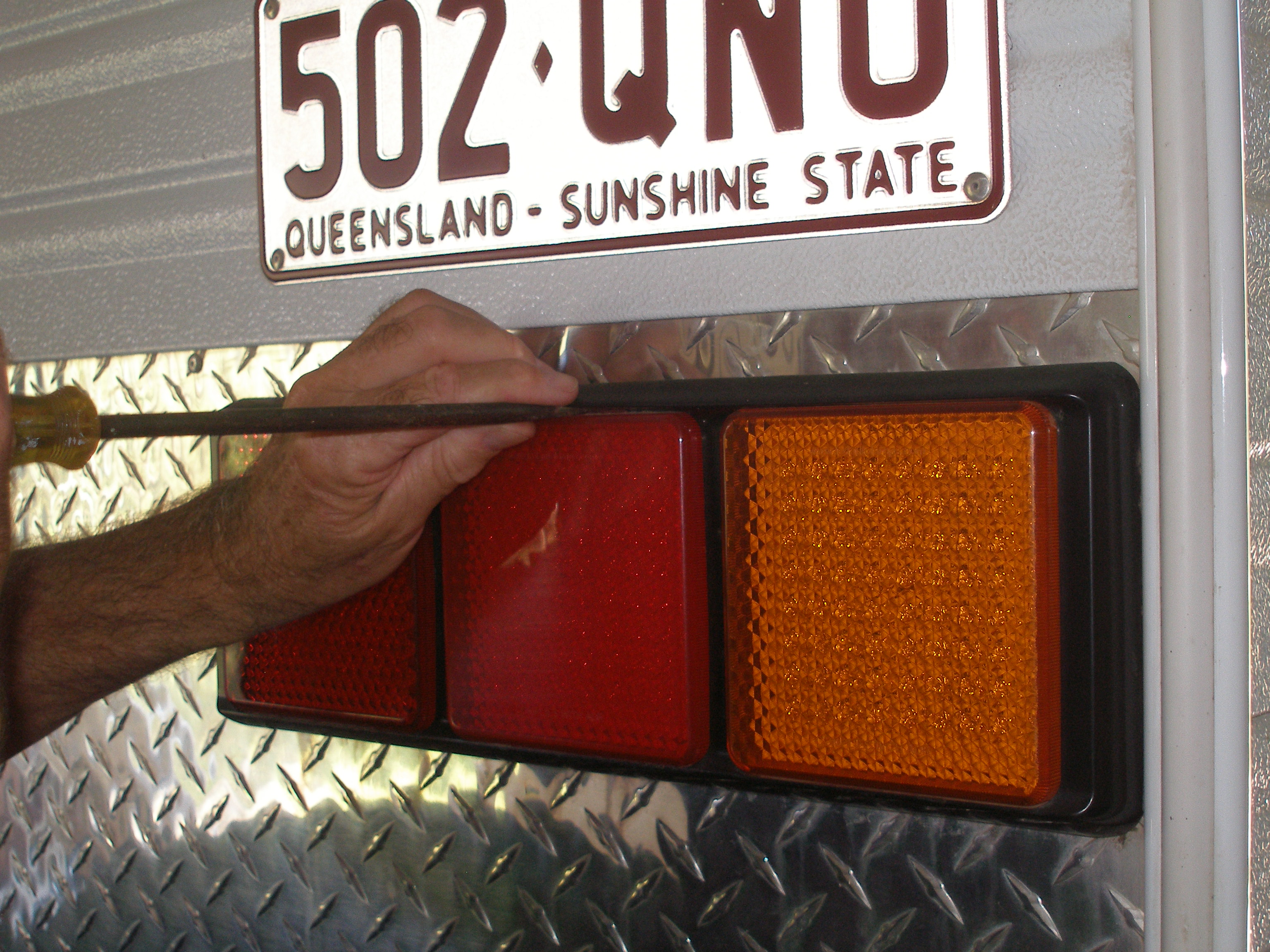

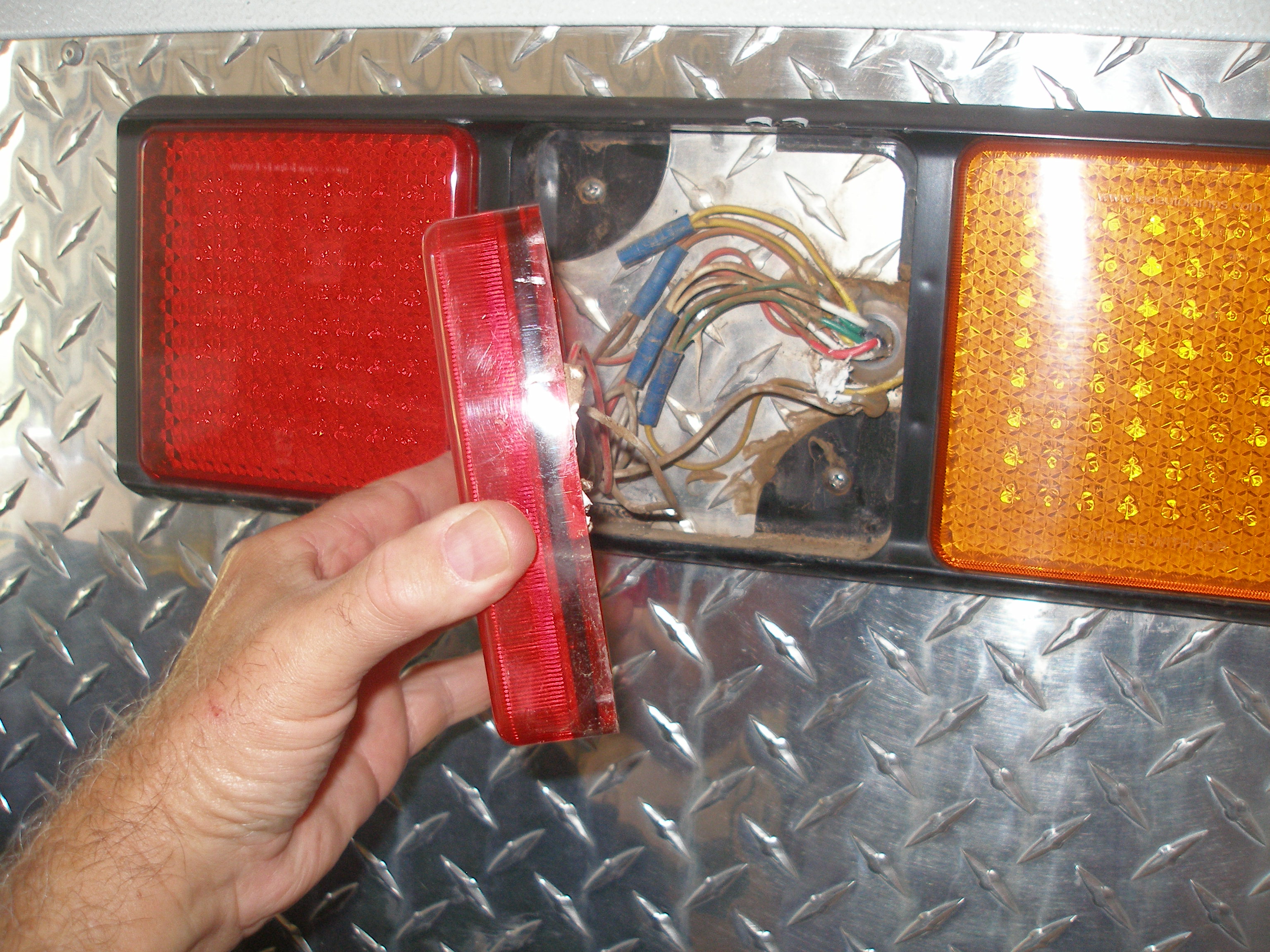

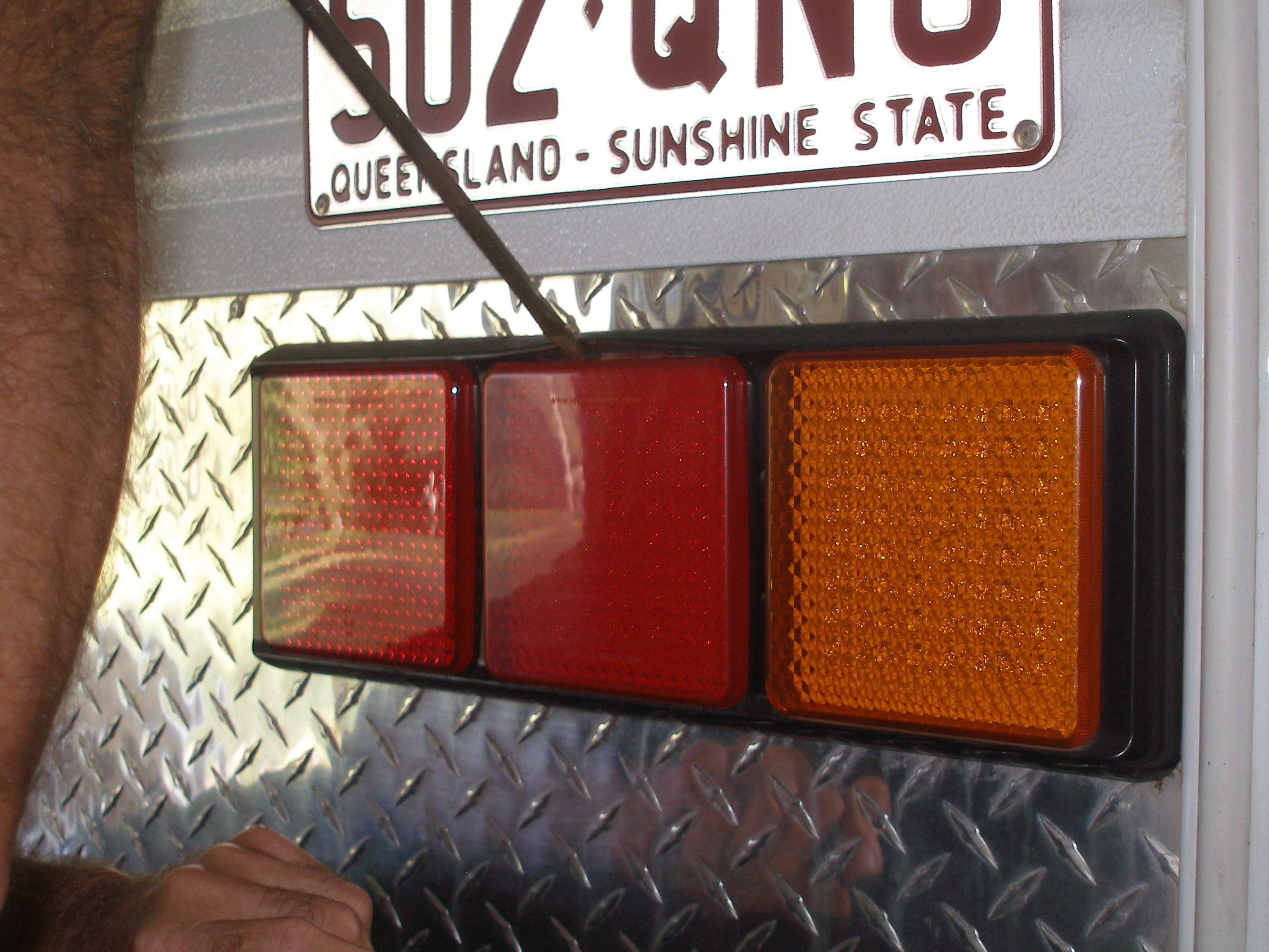

Some pics on how to remove LED lamp sets.
The Sikaflex used when fitting the lamp sets, and mentioned in this thread, does "glue" the lamp into position which can mean a fair bit of force is required to prise the lamp off the back of the van. There is a real risk of chipping the surround. My recomendation is dont take this on unless you have to - when your lamp is blown you have to.
The procedure is in essence to unlock ramped tabs which hold the lamp in the surround. The only thing I have not shown here is the use of a second screwdriver to help prise the lamp out of the surround - required when the Sikaflex has a hold of it.

John,
I know what you mean - leavering away with a big screwdriver could lead to some expensive replacements. I did have photos of this whole operation, and each failed LED lamp, but have misplaced them on the computer. Over the next couple of days I will take a couple of pics and post a methodology.

I removed the failed lamps from the plastic surround. One needs a flat bladed screwdriver to lever the surround away from the lamp and move the lamp outwards, it will then hang on its wires. On close examination I could see fine water droplets inside the lamps and discoloration of the printed circuit boards that carry the LEDs themselves. The construction of these lamps is very high quality - close to a military spec - a moulded outer polycarbonate casing, carrying the PC board with the back sealed with a resin filler, which seals the wire exits. I decided to do some testing of my own. I left the lamps in the sun for an hour then submerged them in a bucket of water. Sure enough water droplets could be seen inside. One lamp had half a teaspoon of water sloshing around in it. Then I left them in the sun again - all sign of water droplets disappeared. On repeating the experiment the same thing happened
Eventually I was able to detect very fine cracks in the corners of the moulded casing. The manufacturer is LED Technologies Pty Ltd who have a comprehensive site at ledautolamps.com.
They manufacture to ISO 9001 standards and claim to use resins and glues which do not crack. The lamps carry a manufacturer's warranty of five years, (van is three years old). I contacted them and was told to return the lamps and if they agreed the product was faulty they would post a replacement. Not the answer one wants to hear on the eve of leaving.
Ashley at the Kedron factory was good enough to replace the faulty lamps and I wired them in and we left on time.

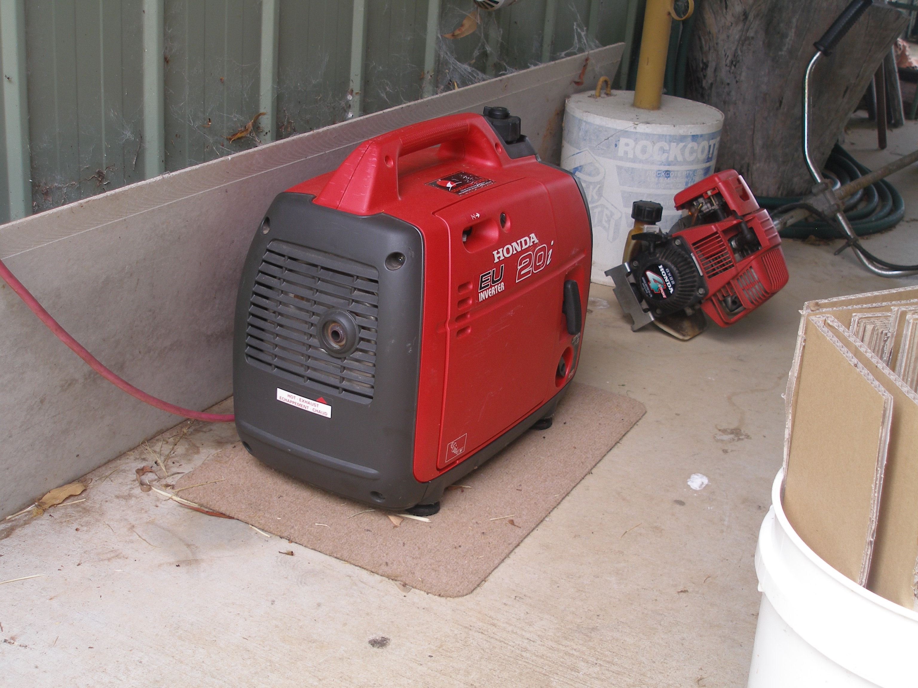

There is a 1.5mtr common eastern brown snake under this generator – not too obvious is he! The generator is the one we carry in the Kedron, it is doing duty at our weekender in this picture.
On a nightly basis I go outside to start the genny to run a pump for 15 mins. I am aware of the snake danger around the Sunshine Coast hinterland but I would have thought that I would be aware of part of a snake sticking out from under such a small footprint. For those of you who have this genny think where the ON/OFF switch is – would you be happy turning it on with such a visitor in residence?
