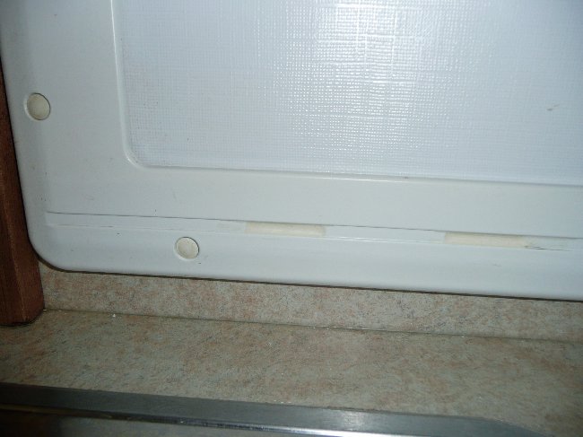

  1. Several years ago we had a significant problem with bugs getting in through the Dometic windows. Ashley referred us to Dometic who could not help, said they were not aware of the problem. So I plugged the slots with Sikaflex, see photo. Not the neatest job in the world but we have not had a problem since. Sometimes they become dirty but a wipe over with turps fixes that. Robert & Jane Jones

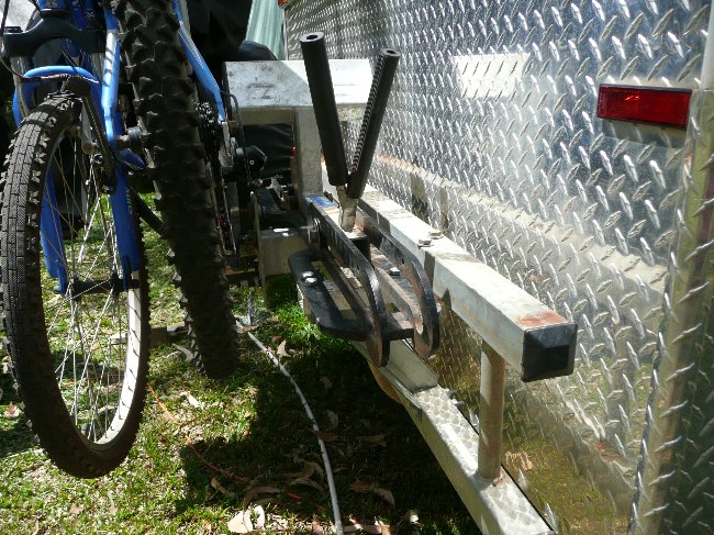

  6. Following Russ's suggestion we have now relocated our swing over outboard mounting bracket to the rear bar of our ATV. The original "slip n easy" outboard mounting bracket was supplied by Kedron fitted to the front A-frame. We were able to change this as we run with only one spare wheel on the rear bar. We feel confident with this as the interchangeable spare from our 100 series means we have two spares in reality, and we have successfully used our tyre repair kit in the past. We positioned the outboard bracket over the spare mounting point so it takes most of the load, and made up an additional bracket as shown in the attached photo. Robert & Jane Jones
