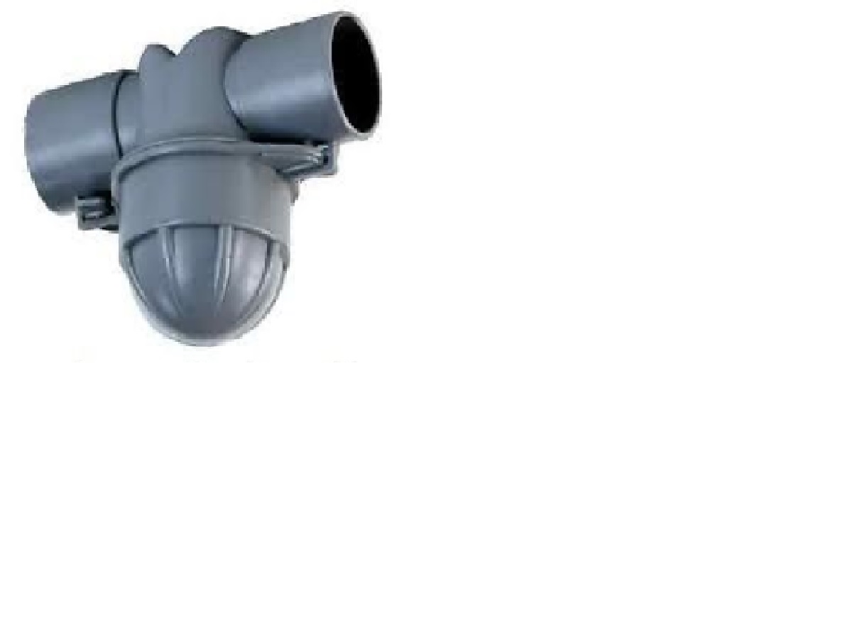

  2. Hi Merv Thank you for the great information. The current setup for the waste water is the en suite sink and the kitchen sink are connected together and the washing machine connects to the shower drain. There is a large tap fitted to the shower drain hose as the previous owner mentioned that the washing machine would start to go into the shower drain as the machines pump pressure was quite strong and the outlet would have a slight restriction to the flow. Kitchen/Vanity and washing machine connect into a T then the shower is then connected with a second T which drains all to the outside. I was considering not having the washing machine going to the grey water tank as we will only use it when we can drain to ground or van park. I was going to attach the waste gate (below) to the sink/vanity and shower grey water inlets to stop the odor coming back up. I will also take your advice to use a 32mm outlet for the drain. The existing water tank is wrapped with 1mm or 1.5mm Gal sheet screwed to the rails under the van in between the axles (independent suspension). I am only doing this as I have 4 x 80ltr tanks and as we are only starting out we wont need all that water and will probably spend a lot of time in CP's until we get a bit more confident to start to free camp a lot more and after we retire. Stay safe and thanks again for the info. Garry
