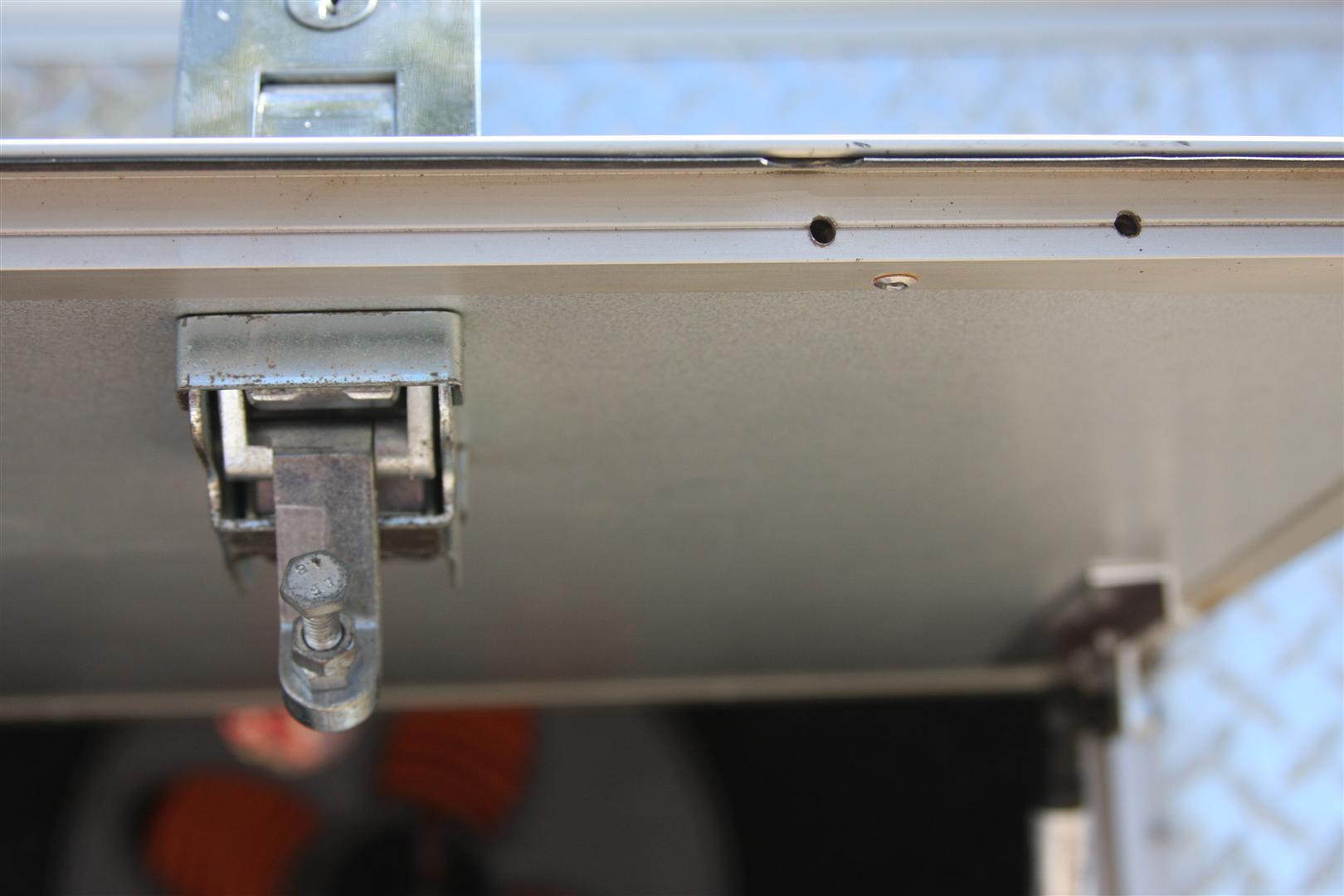

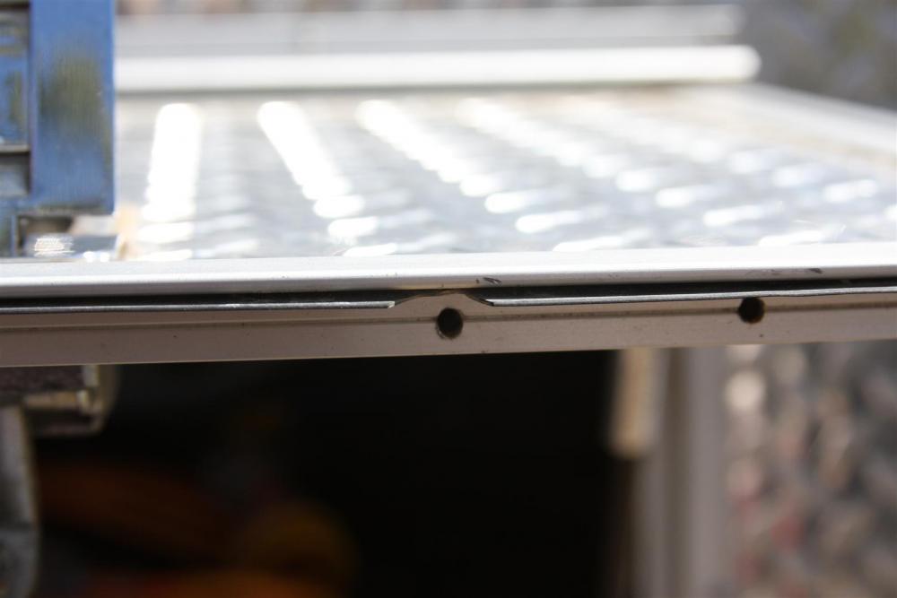

    OK so I have found a supposed fix from another forum which I am probably going to try it includes nicking out the rubber seal in 2 places per door to line up with the door drain holes on the bottom edge attached are the photos the writer provided
