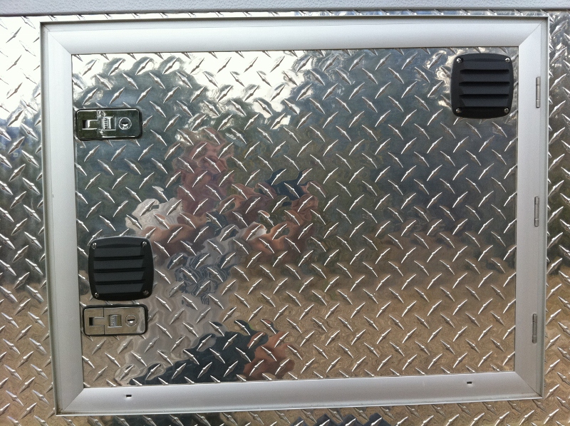

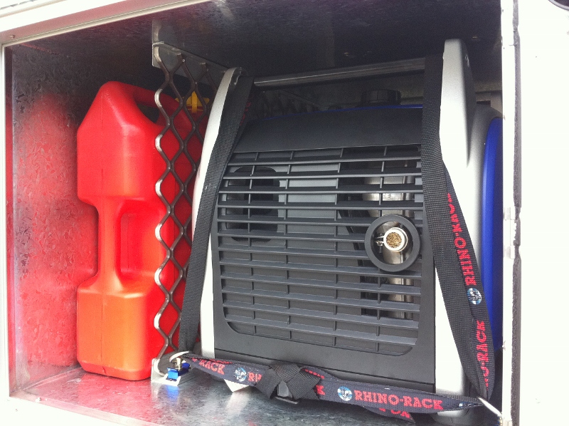

John and Ann Posted April 23, 2011 Report Posted April 23, 2011 Hi All,Well bit the bullet and ditched the Honda EU20i. No matter what I did and whom ever I spoke with none of their suggestions kept it running with the Cormorant on line.Debated the Yamaha EF2400i vs EF2800i but concluded that although 2800 was considerably cheaper and had quite a bit more power, I and my fellow travellers would be unhappy with the additional noise.So out with the EU20i, generator slide and thanks to Danny & Sue's tip earlier in this thread in went the divider, EF2400i, tie downs, and 2 x 10l of fuel with space left over for the water pumping kit (notice the two vents I have cut into the door to provide some cross ventilation to keep it safe in there), job done, a happy camper again. :thumbsup: Oh and yes I did a test for about 4hrs with the Cormorant cooling down a hot van and charging batteries, never missed a beat.Here are some pics for those interested in the detail: Quote
