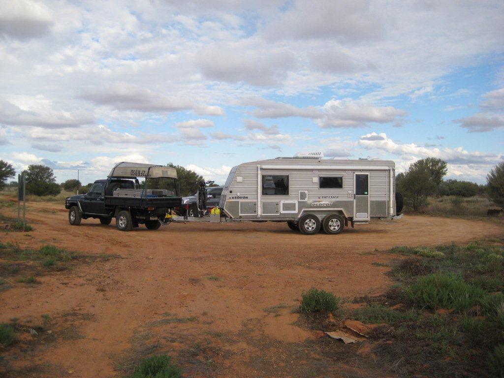

Hi Rick, we tow the 21 foot Topender with a GXL ute, when you look at the attached photo the clearance from the tray is ample. Do you have a tray that is much lower. also can you send us a photo of the new type of towbar, ours was the old type and I would not reccomend it, regards Mark and Simone -

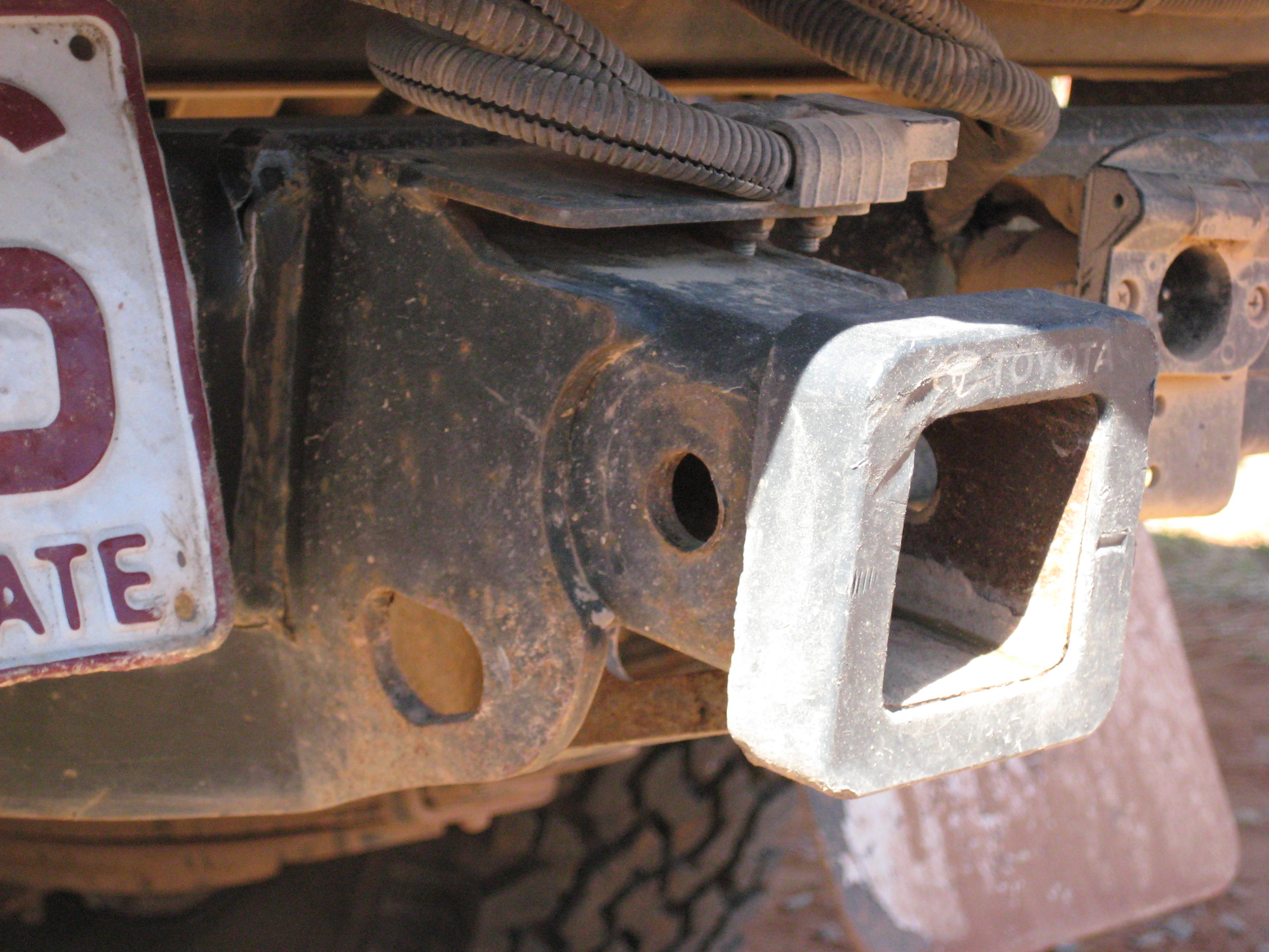

Thanks Rod for your reply, I will be interested to see the results of our weighbridge, when I can modify this towbar to drive it there.
Thanks Phill, we are currently modifying the towbar and will head directly to a weighbridge to confirm weights.
Hi all, has anyone else had any trouble with the Hayman Reese towbar when towing a 21 foot Topender,as you can see by the attached photo we have cracked the weld on the hayman Reese tube attached to the box section of the towbar, this is the tube which houses the tongue. Had this detached fully from the vehicle the van would have dropped on to the road as the Safety Chain shackles are also attached to this section.Relying on the emergency brake to stop momentum. We are mindful of weight as all Kedron Topender owners are being in the High weight zone, the "A" frame has the standard 2 jerry cans filled, 2 x 9kg. Gas Bottles filled,and a trailer mate jack. The boot only has the 3of factory fitted batteries c/w inverter and solar charger and 2x light fold up chairs. Under the bed is the usual clothes ,Dreampot etc. nothing of extreme weight, all my heavy gear rides in tool boxes on the ute.We have the 6 tonne McHitch fitted and run WITHOUT the weight distrubution bars attached, The Cruiser Ute has Airbag suspension and upgraded springs, any clues??. we are currently laid up in a small town and when mobile I will have the whole rig over the weighbridge to prove exact weights. Regards Mark and Simone
