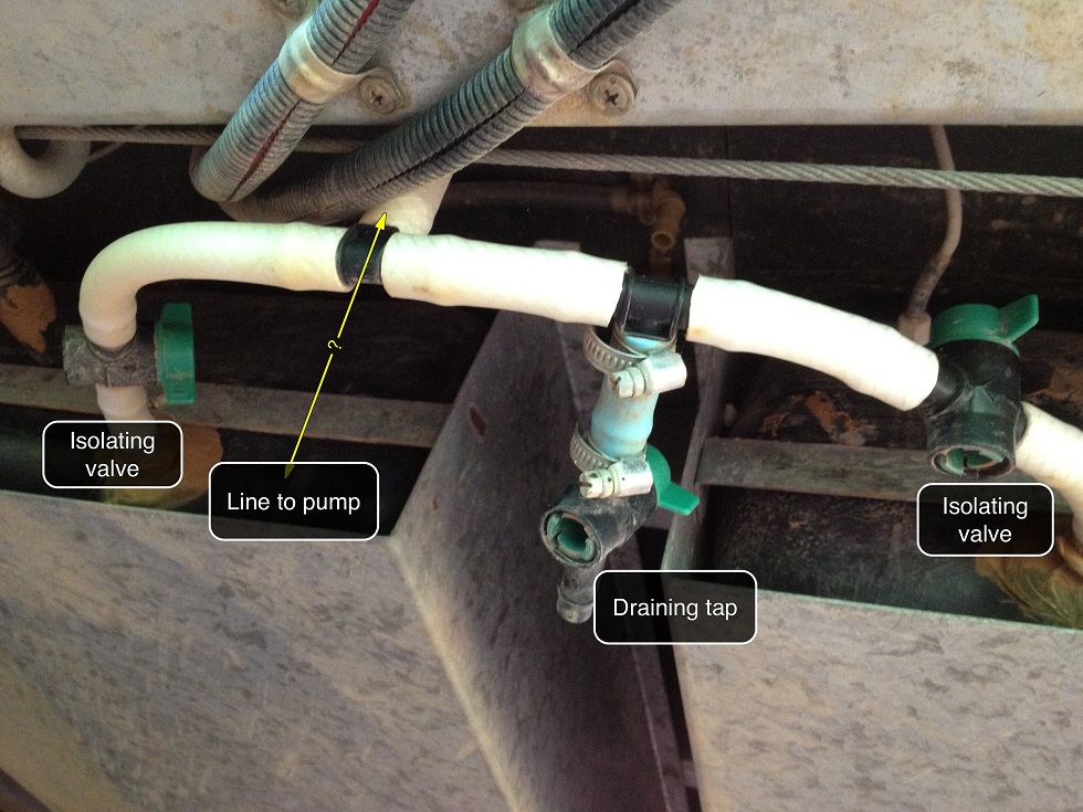

Alan and Liz Jones Posted January 13, 2012 Report Posted January 13, 2012 Happy New Year ,I will not be using the van untill the end of March and decided to drain the water tanks. I drained the hot water , no worries . Can somebody let me know how to drain the tanks please. My old van (not a Kedron) had drain taps. The van is a 2011 ATV with 2 X 100lt and 1 X 60lt.Thanks NevHi Nev,I have fitted isolating valves and draining taps in the existing lines so I can use and/or drain the tanks individually. I have also plumbed the drinking water tank into shower water pump via an isolating valve. This means I can use water from any one of the four tanks at a time, therefore on short trips I only have to fill the tank/s I need. Also I drain off excess water for the trip home or to the next reliable water supply, saving weight to be towed. Taps and valves are available in the garden section of any hardware store. Quote
Alan and Liz Jones Posted January 13, 2012 Report Posted January 13, 2012 Hi Nev,Tried to attach photos but didn't seem to work.Alan Quote
Alan and Liz Jones Posted January 13, 2012 Report Posted January 13, 2012 Hi Nev,Here is the photo I was trying to post. It's of the front two tanks other two are done in a similar way.CheersAlan Quote
Alan and Liz Jones Posted January 13, 2012 Report Posted January 13, 2012 Sorry Nev,I just realised that the photo is too small to see it properly. Try this one.CheersAlan Quote

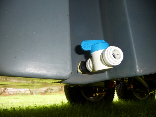

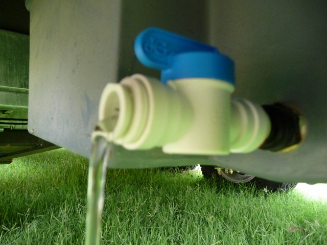

Trish and Carl Posted January 17, 2012 Report Posted January 17, 2012 Dear Nev and PennyWe have the same van 2011 - (ATV)we always drain our tanks when we store it - water goes stagnent We also take out the water filter and store it in our home fridge as per recommendation in the handbookto drain the tanks you will need about a 27-28 mm ring spannerOn ours there are drain plugs on each tank on the left hand side of the tankshope this helpscheersCarl & Trish Quote
Nev and Penny Posted January 17, 2012 Author Report Posted January 17, 2012 Thanks Carl and trishI'm looking into to see if it is possible to put a tap into that fitting.I will let you know how I goCheers Nev Quote
Nev and Penny Posted January 22, 2012 Author Report Posted January 22, 2012 Hi Everybody,I fitted the same taps that are used in the water system in the van as drain taps for the tanks.Here are the pics. Cheers Nev Quote
