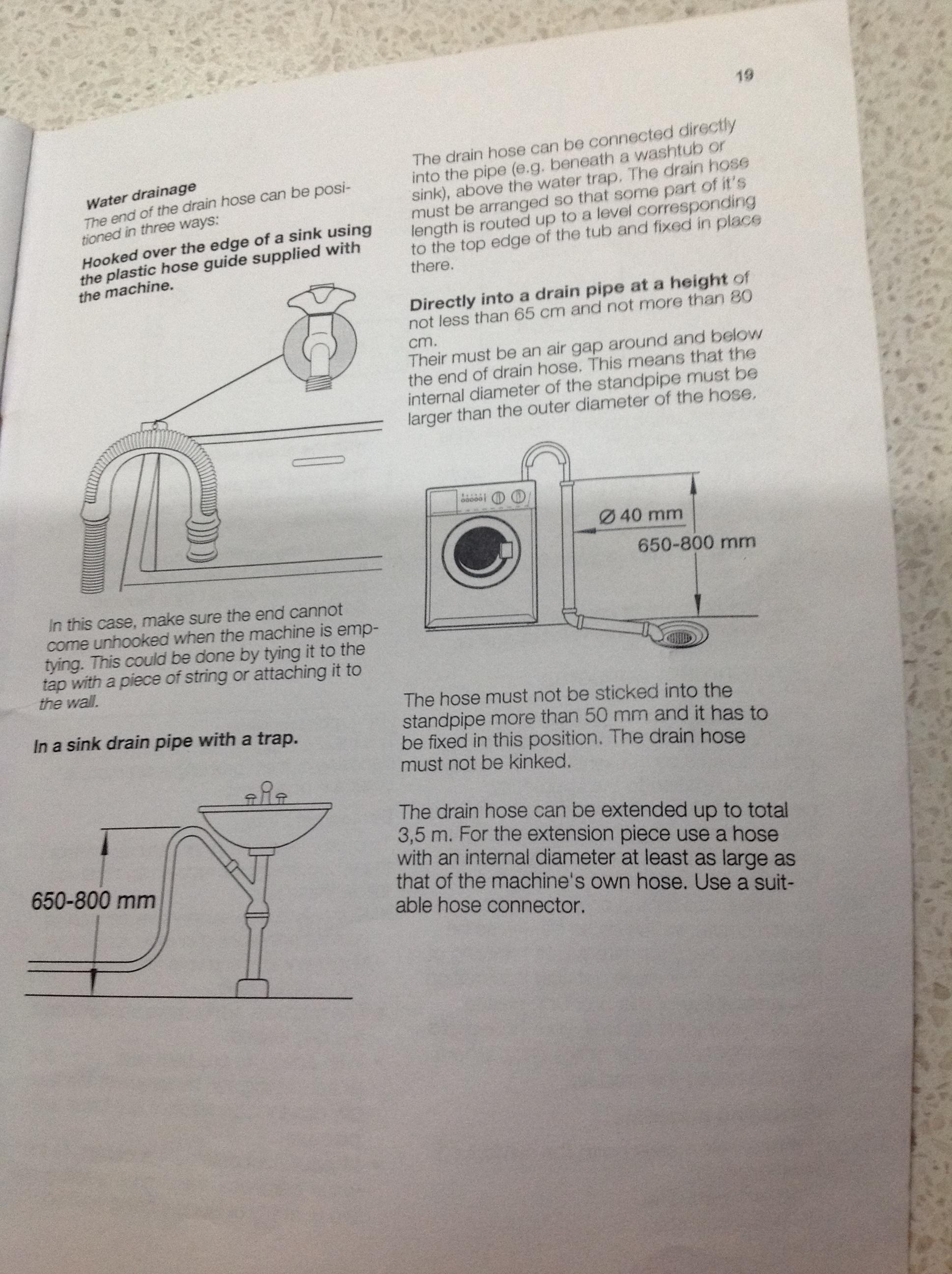

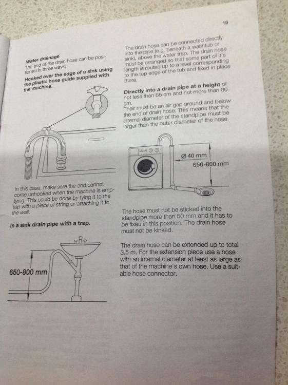

Hi Curly, we have a Dometic front loader but not as old as yours and no problems with it so far. The User Manual indicates this problem occurs if the end of the drain hose is too low.  Perhaps the hose has shaken loose. Copies of P14 & P19 attached - hope this helps.
