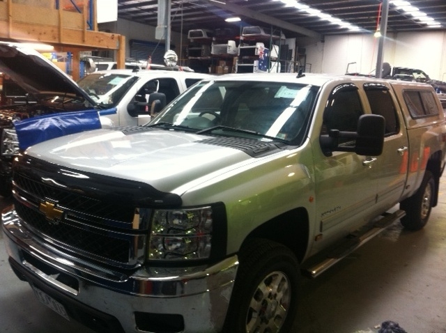

David Hunt Posted January 15, 2012 Report Posted January 15, 2012 Hi AllThe Last trip I made in Feb 2011, I was Pulled over & weighed by the RTA, My tow vehicle was a 100 series V8 Petrol (33 lt per 100km)towing a Topender fully fitted out, also carrying a collapsable boat trailer on the rear, outboard on the front & boat on the car roof. I went over the 3500kg, luckily I was let off with a warning.I searched everywhere as I also heard the car tow capacity could be increased, unfortunately I had no luck.In the end I purchases a new Chev silverado 3500 HD 6.6lt turbo diesel fully optioned excluding Sunroof. Eventually buying it through American car sales in Vic as they where prepared to negotiate. It cost 107K plus $3800 onroad, only draw back is you need a LR licience which you can do through the RTA for $48.Certainly fixed the towing problem. CheersDavid Quote
John and Ann Posted January 16, 2012 Report Posted January 16, 2012 Hi David,Am thinking of that tow vehicle myself because of the weight issues. Did you consider downgrading the Silverado slightly to allow you to drive it on C Class license? Quote
Graham and Sue Posted January 16, 2012 Report Posted January 16, 2012 Hi David,Am thinking of that tow vehicle myself because of the weight issues. Did you consider downgrading the Silverado slightly to allow you to drive it on C Class license?Hello All.We have the 2500 Silverado, which we drive on a C class lisence. Does your Silverado have dual wheels.Best Wishes. Sue Quote
Mr Wato Posted January 16, 2012 Report Posted January 16, 2012 Hi AllI also bought a 2500 Silverado, I had the gvm lowered 50kg by an engineer so it can be driven on a car licence, The dealer organised the gvm decrease, it cost $400.00 to do it. The Chevy is the nicest car/truck I have ever driven..Cheers Phil Quote
David Hunt Posted January 16, 2012 Report Posted January 16, 2012 Hi AllOrigionally I was going to purchase the 2500HD but was told that the New 2011 was 50kg heavier than the previous models & would require a LR Licience. I had heard a few Vehicles had their GVM lowered & therefore could be driven on a C class licience. Not sure if that applies to the new 2011 model.I had the opportunity to purchase the hew 2011 3500HD at the same price as the 2500Hd, the 3500Hd has heavier running gear which increases the Payload from 1417kg to 1917kg, pushing the GVM to 5218kg, well over the 4500kg limit. The curb weight is only 100kg heavier. The extra weight suited me as I sometimes take a quad bike for beach fishing.If you do not need the extra payload as both vehicles can tow a trailer up to 5896 KG, I would suggest you purchase a 2500Hd, have the GVM reduced if that is still possible. Not sure how much that reduces the trailer tow capacity but it will certainly still tow any van with ease.Upgading to a LR means your Greenslips are higher unleass you can register the vehicle through a business. I found the process of taking the test very easy.Sue & Graham, no the vehicle is a Crewcab standard box 4X4.Whilst I have not had the opportunity to tow the Topender on any long trips as yet ( heading off to WA in mid Feb for 7 weeks & Cape york in mid august for 7 wks)I concur with Phil & Darlene, the vehicle drives extremely well, leaves my V8 100series for dead..Std driving, the manufacturer quotes 15 lt per 100km, the vehicle is only 6 wks old, currently getting 14.7lt per 100km. Phil & Darlene, I would be very interested in what your fuel useage is when towing. It will definately leave the 33lt per 10km Iwas getting from the petrol 100 series. If anyone would like more info on my experiences when purchasing a chevy please email dhunt@woolworths.com.au & I will be only to happy to respond via email of phone.Cheers DavidHope this photo attached correctly Quote
