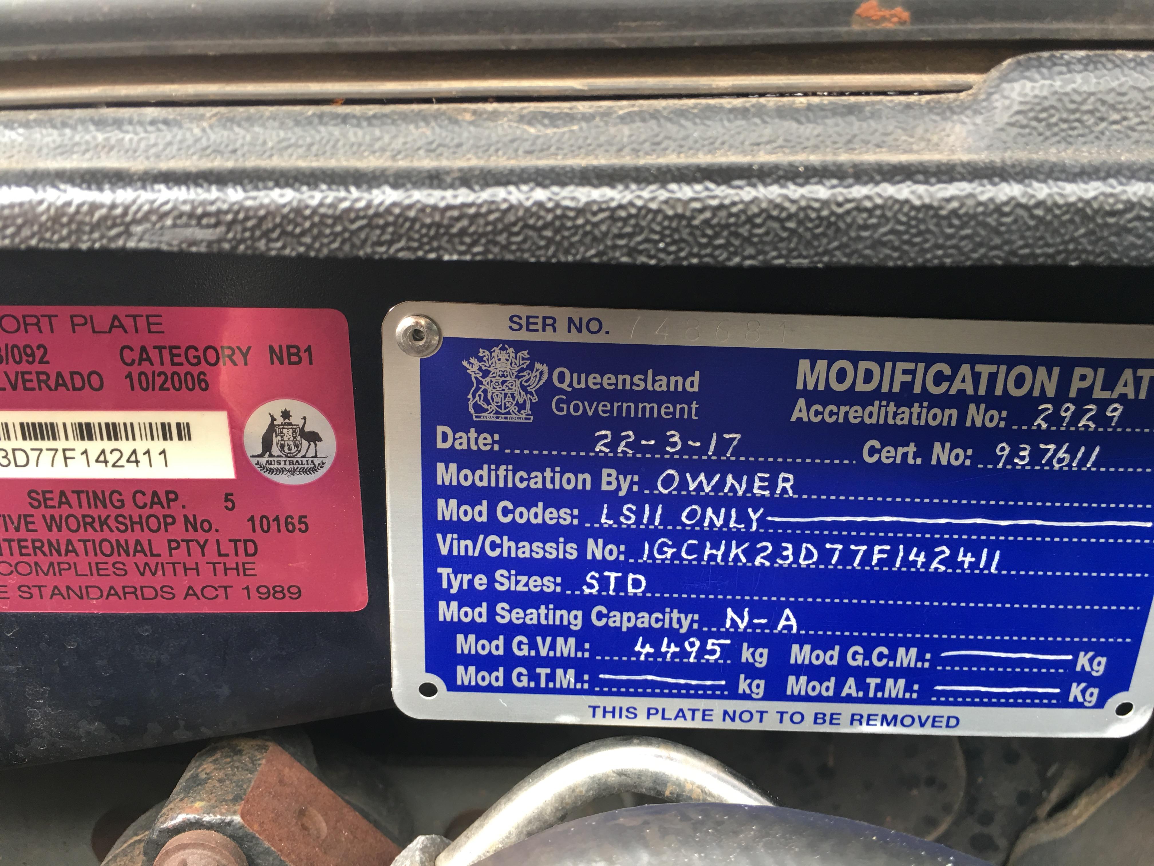

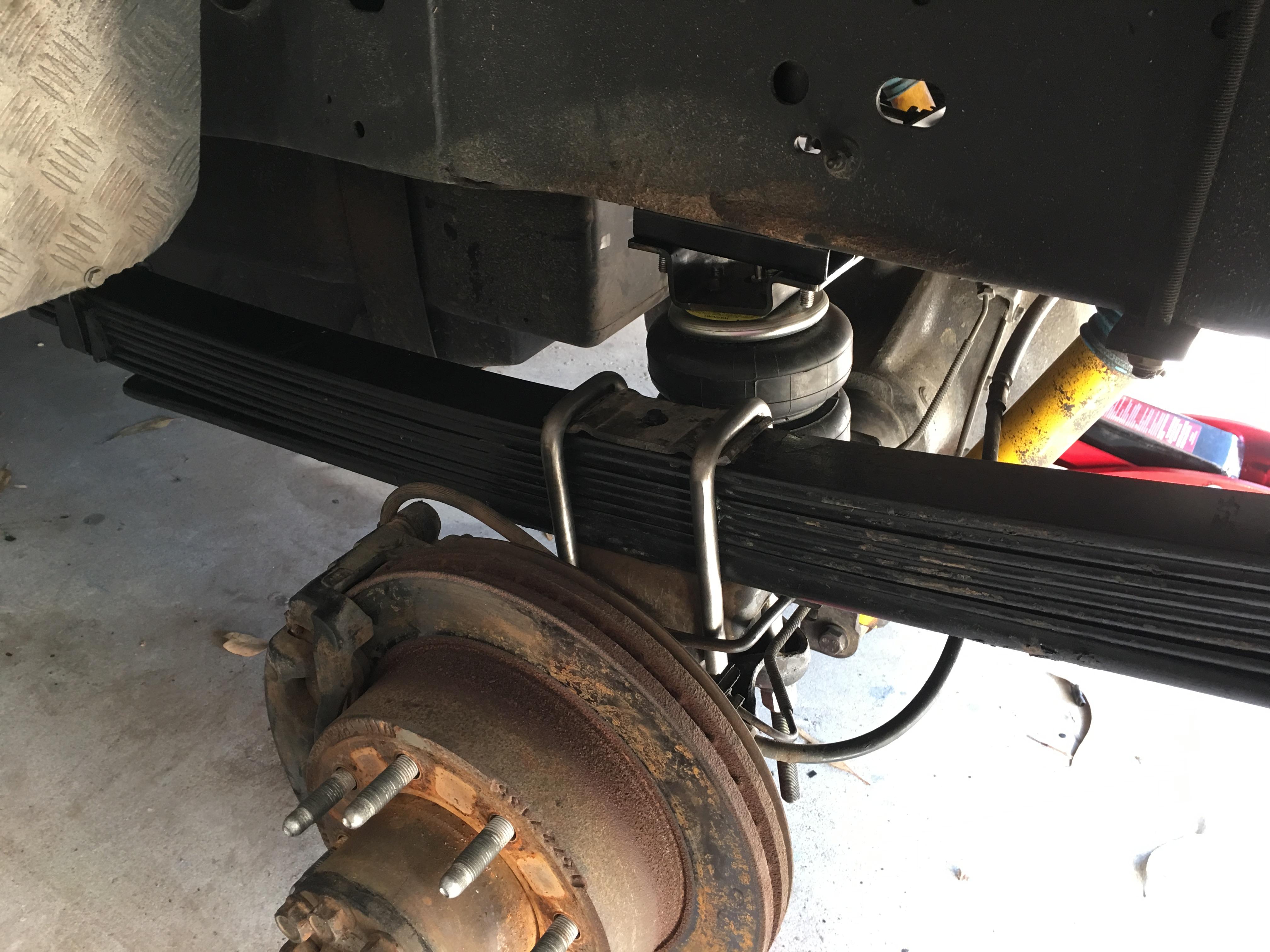

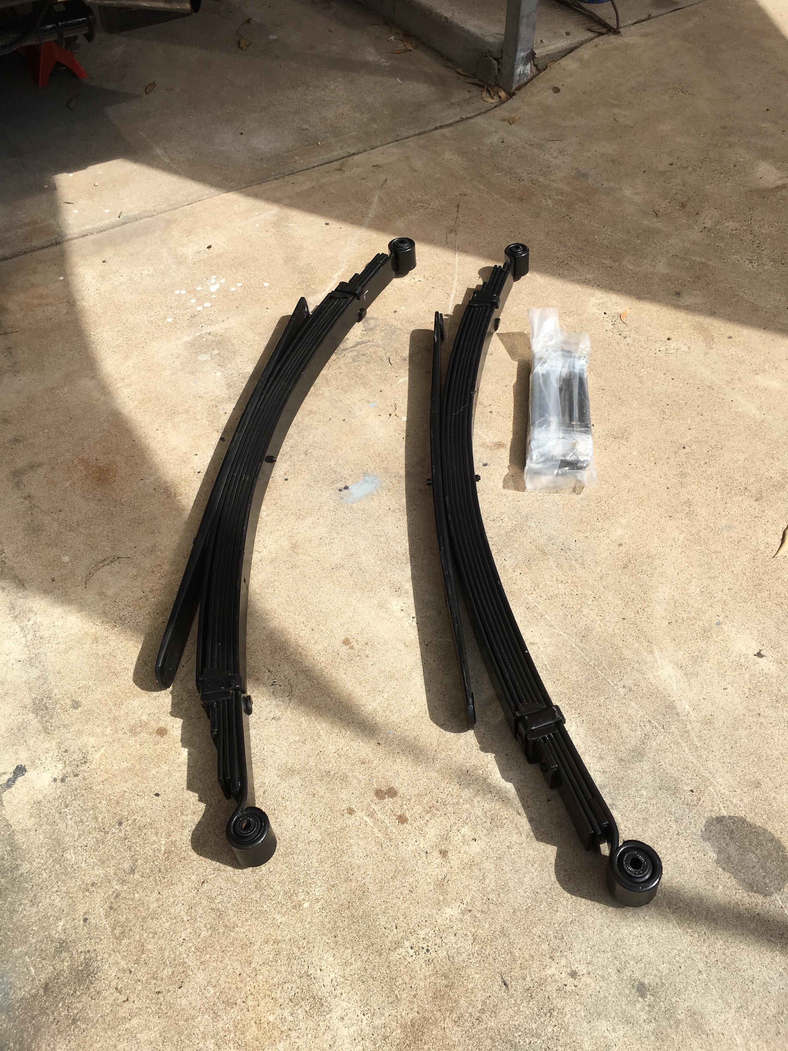

Bryan, To upgrade to 4495kg GVM on a 2500, you need to bring the rear springs to 3500 specifications. This requires the addition of 3 extra leaves per set. The LS11 certification, can than be carried out by a qualified mechanical engineer in Queensland. I did all the work myself, and had the springs upgraded at a local spring works, than refitted them. (they are heavy) I already had airbags fitted. When the upgraded springs were fitted I also needed to install a 25mm spacer for the air bags. The certification for mine was carried out before the latest government saga's but should still be able to be carried out, you also need to ensure your brakes are up to standard as the vehicle is put through a rigorous series of brake tests as part of the upgrade process. Some information attached, I used for the engineer to confirm my research. You need the specifications of the 3500 spring pack (attached), when you get the 3 new leaves installed they need to reset the springs to the 3500 specifications. Hope this helps. cheers Replacement Leaf Springs for the 2006 Chevrolet Silverado 3500.webarchive

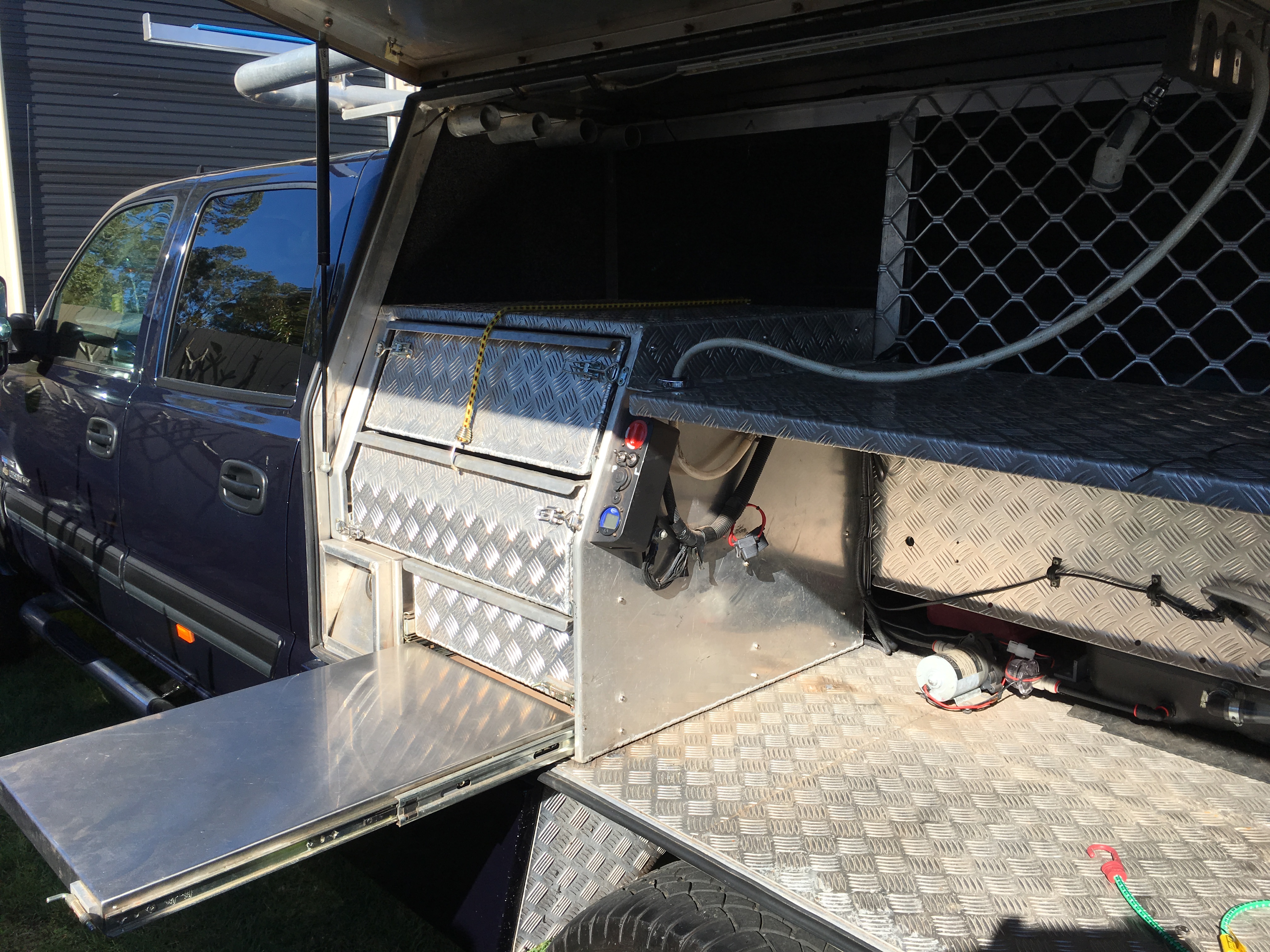

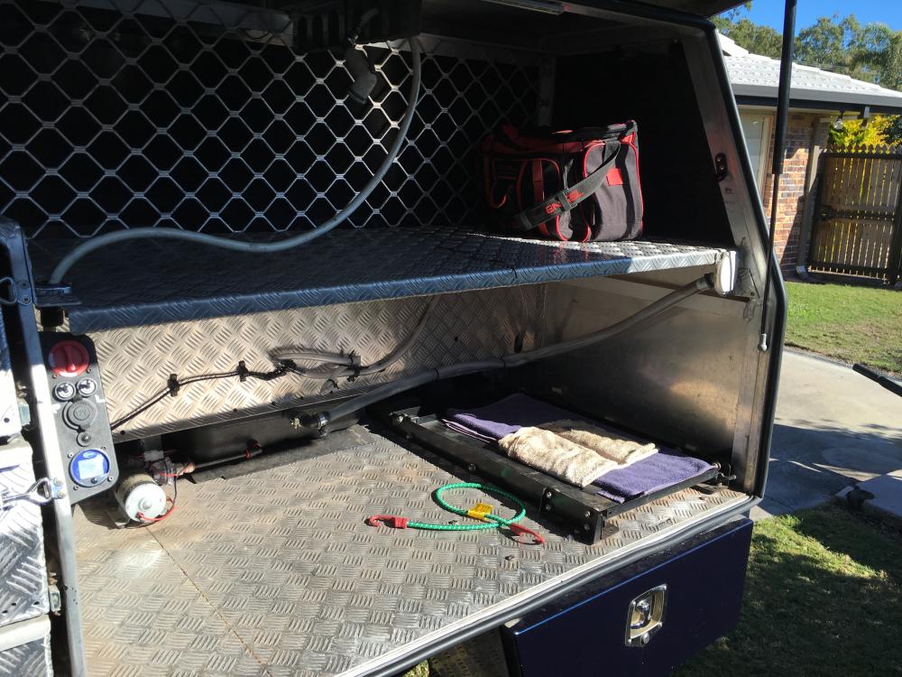

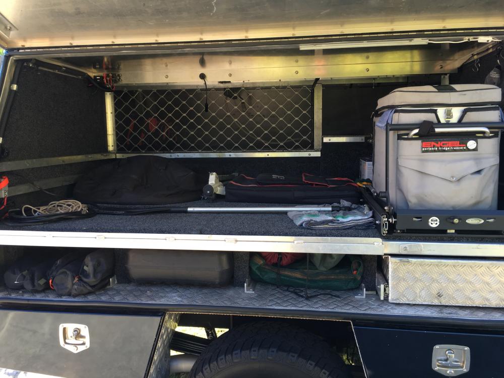

Hi, I will get all the dimensions tomorrow, just finished making my boat loader today so will be testing it over the next few days to make sure it works like I planned. I had already made one but I wasn't happy so I redesigned it. The back was on the truck when we bought it and I haven't been able to find any makers identity, the gear on the back is why I was happy to go back to a 2006 unit. I know it is 2.2m long, divided in the middle all aluminium, with 4 external boxes and an additional one underneath accessed from the rear. On the passenger side the fuel cap is inside. I have a stainless steel pull out table and 3 sets of draws above, a mid height shelf extends from the side of the draws to the rear wall, this is large enough to house the sat dish and folding solar panel. On the lower compartment it had a fridge slide, our fridge wouldn't fit on it so I have installed our 3kw generator. Also on this side is the light controls, shower pump (same as in the van) switch and battery isolator and our two folding chairs. On the drivers side a shelf runs the full length, I have the fridge mounted up front on a drop down slide we had that in the cruiser. Behind the fridge in the rear lower compartment is 2 x 120 amp hour batteries. A full size draw is directly under the fridge. Next to that I have three compartments, one for the ladder and 2 smaller chairs, next one has a 60 litre water tank, last one has all the awnings and equipment for the fox wing. In the shelf is a pull out slide which enables you to turn it into a double bed. At the moment this area is empty, but thinking of moving the sat dish back over this side. A couple of photo's to give you an idea. In the four outside boxes I carry some spare hoses and the tyre changing gear, 2 are still empty. cheers
