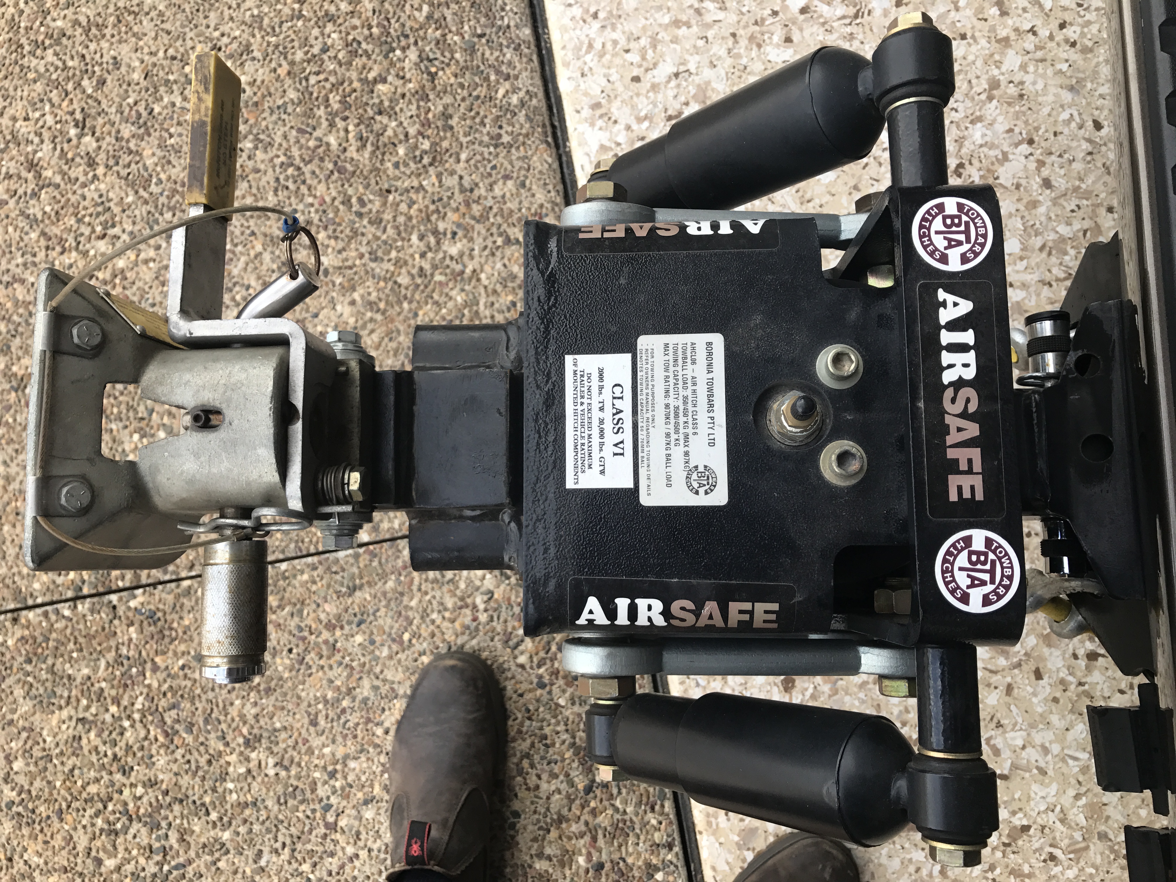

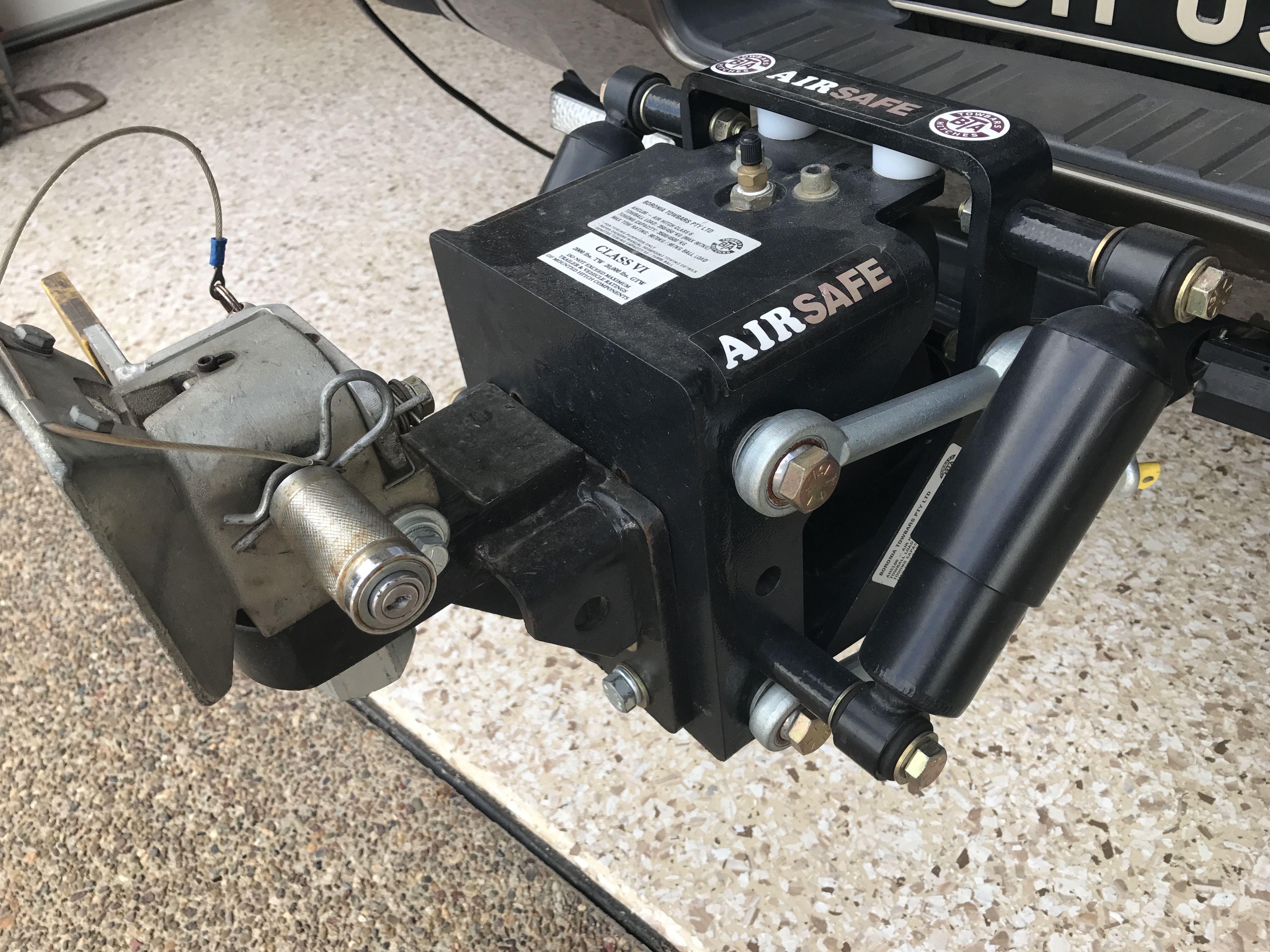

TonyH Posted June 10, 2017 Report Posted June 10, 2017 Hi Danny, Here are a couple of photos of the 'Air Safe' Hitch (Class 6) 1 Quote

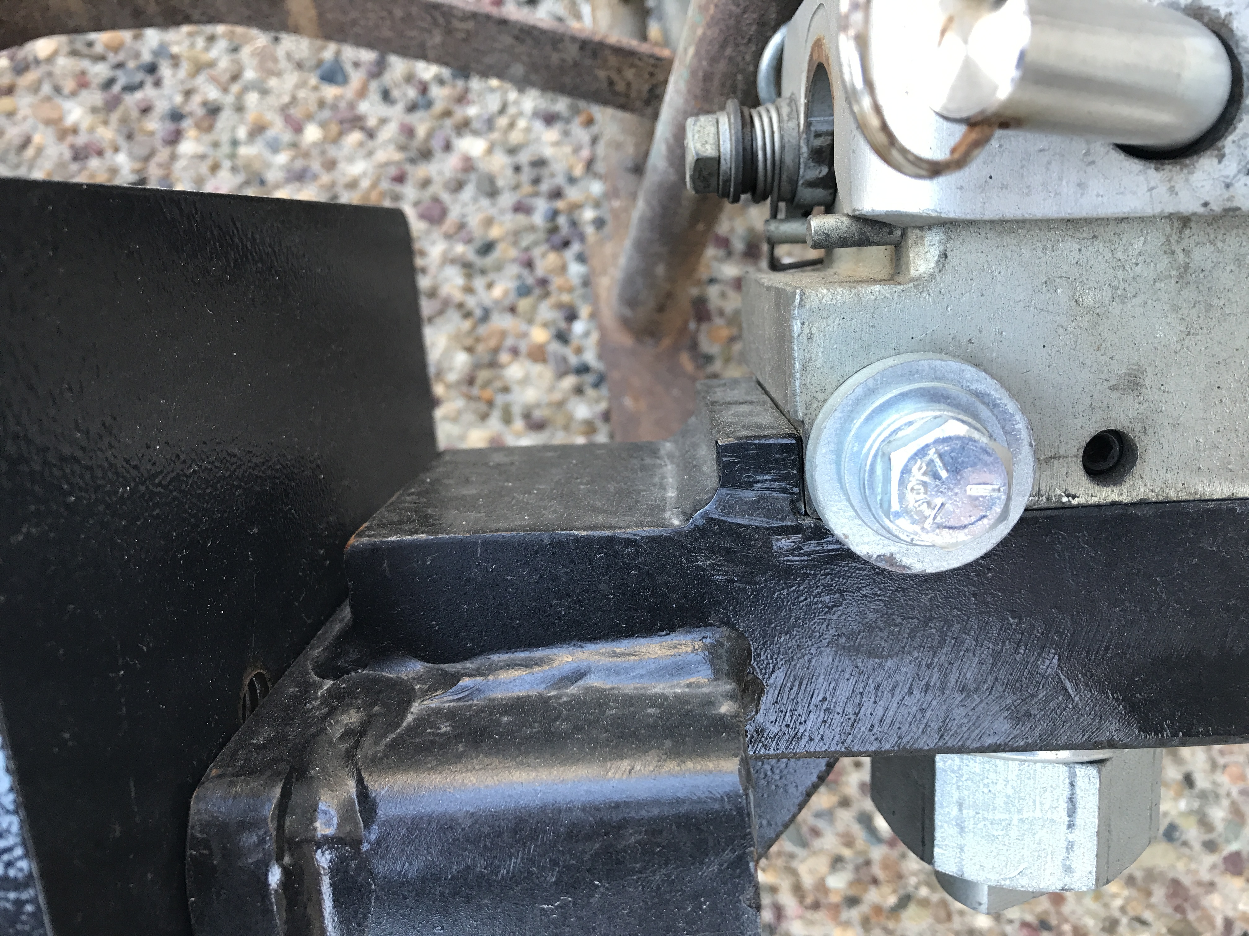

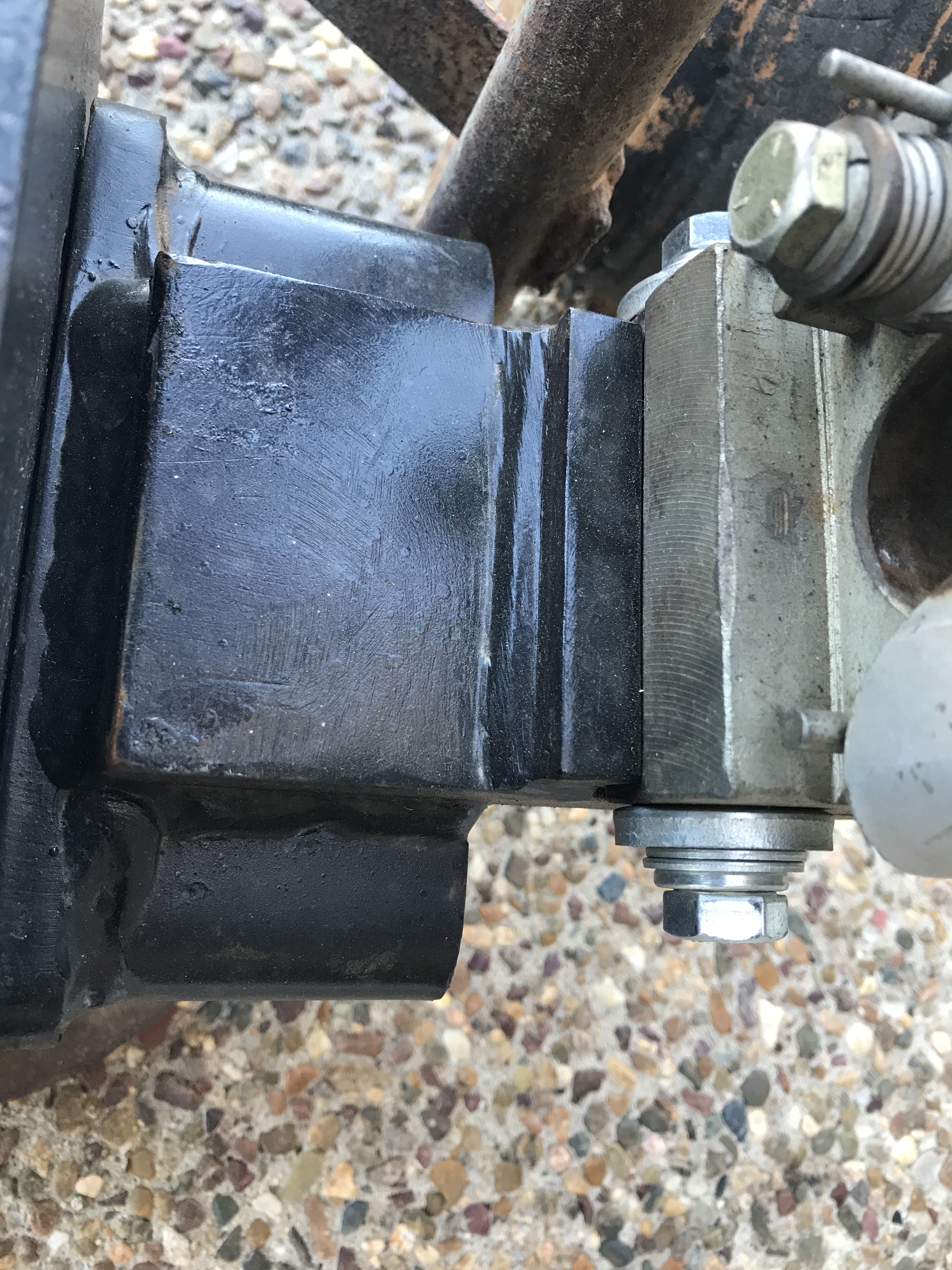

Merv and Di Posted June 19, 2017 Report Posted June 19, 2017 Hi Tony Is there a separate plate between the receiver and the tow tongue to stop the receiver from moving sideways or is it only the two bolts that prevent this movement? I was reading a post on the caravaners forum stating that a plate was to be welded to the tongue to prevent this movement, truth or fiction or not required? Thanks Merv Quote
TonyH Posted June 20, 2017 Report Posted June 20, 2017 53 minutes ago, Merv and Di said: Is there a separate plate between the receiver and the tow tongue to stop the receiver from moving sideways or is it only the two bolts that prevent this movement? Hi Merv, As you can see from the photos, yes I have a bolt and a heavy washer on each side of the McHitch receiver to stop the receiver 'twisting' sideways. I have also welded a length of square bar (10mm) onto the tongue at the 'rear' of the receiver also to stop the 'twisting' On 6/19/2017 at 7:21 AM, Neville and Kay said: With the Air Safe Hitch how does the Cantilever affect of the hitch go on the original Tow Bar as the weight is quite some way back from where the original tow ball would of been, and I wondered if this would have more of a twisting affect which puts more pressure on fixing points of Tow Bar. Hi Nev, I had never really thought about the 'load' being further back,(than a standard towball) but I guess it is just a little further back....whats an inch or two between friends. I just adjust the air pressure in the hitch (so the arms are level...pump up hitch bag to about 80psi before putting van on, then connect van then drop pressure in hitch bag until 'arms' are level) &......adjust the pressure in the air bags (Air Bag Man) on the rear of the truck I am truly not aware of any extra or undue twisting from this setup, I really can only give very positive feedback as the difference between using the standard Haymen Reece set up compared to the Air Hitch is chalk and cheese! Cheers, CU down the road Tony. Quote
