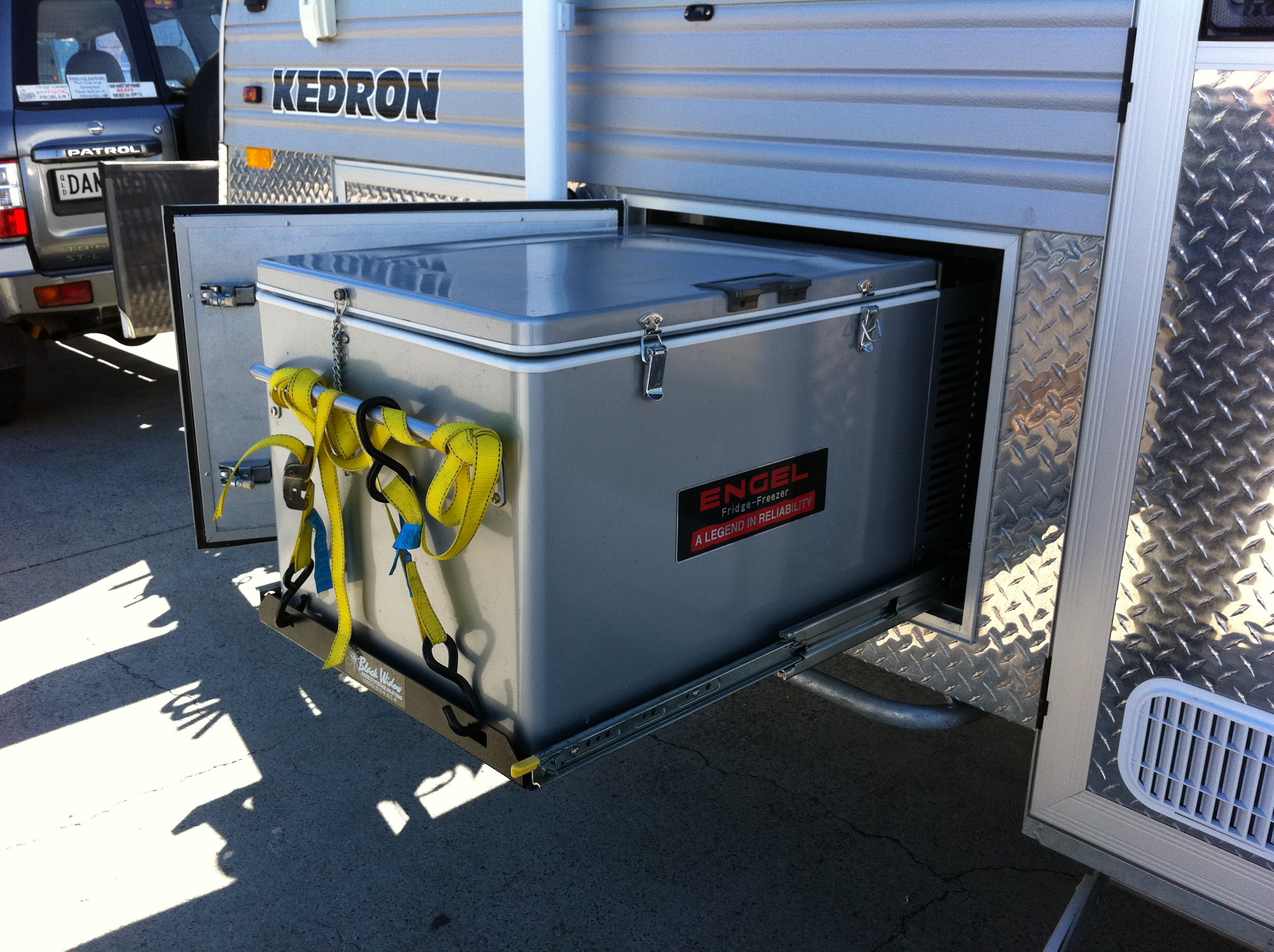

Webby Posted November 23, 2011 Report Share Posted November 23, 2011 I have been given a couple of photos from Tom at the Kedron factory from someone who contacted Black Widow to have a low profile custom made fridge slide made. I have contacted Black Widow and they confirm they made the fridge slide, but they did not make the genny slide. As you can see they are very similar, but I am interested in the genny slide in particular and contacting the owner to obtain more information on the slides. The number plate on the Patrol is "Damage", so shouldn't be hard to spot.So if you're the owner and you are reading this, please in contact me as I'd love to have a chat.Cheers Quote Link to comment Share on other sites More sharing options...

Rodsta08 Posted August 1, 2012 Report Share Posted August 1, 2012 Hi There Webby,New to the KOG family, as we picked up our new XC3 a few weeks ago.I was the guy that made both slides (not black widow) for my boss' 2009 Topender - DAMAGEAs the generator slide is the one that concerns you it can be made may any competent metal worker. If you are still wanting to discuss this, please get in contact with me & we can go from there.. Cheers Roddo (& Stace) Quote Link to comment Share on other sites More sharing options...
Webby Posted August 1, 2012 Author Report Share Posted August 1, 2012 Hi RoddoThanks for taking the time to post. Yes, I was searching for some info on that Genny slide when our van was being built back in January, and as you suggested I got in touch with a metal worker who made the tray. I used the sliders from a Black Widow slide. It was a tight fit, but with some tweaking, the 2.4 Yamaha fits (just). Thanks again. Quote Link to comment Share on other sites More sharing options...
