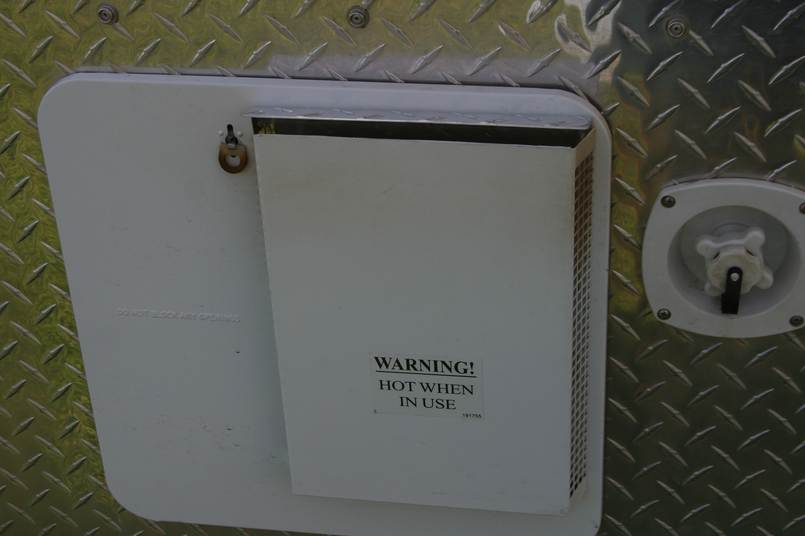

Jacky Jacky Posted August 11, 2012 Report Posted August 11, 2012 Hi Richard & Celeste,I assume it is a Suburban HWS. There were a few of these HWS sold with a cowl (external cover) that had insufficient spaces for air to allow the gas to ignite. You could try opening the whole cover to allow more air in. We know of a few people who had a similar problem and had the cowl replaced with the 'newer' design. Vacuum out any dust from time to time. Other than that, check your gas supply - but you have probably done that. Quote

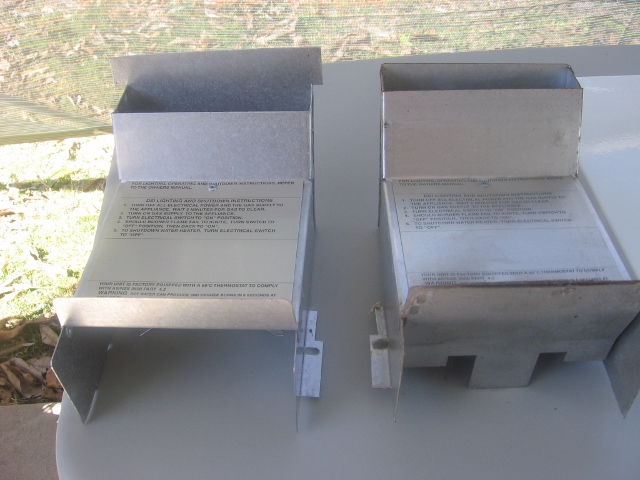

RickA Posted August 11, 2012 Report Posted August 11, 2012 Hi Richard and CelesteWe have the problem occasionaly after a lot of dust.The fix I use is a fine needle or pin and a pair of needle nose pliers and give the jet a GENTLE reem out. It doesn`t take much to block them.A couple of piccies to help??!!CheersRick Quote

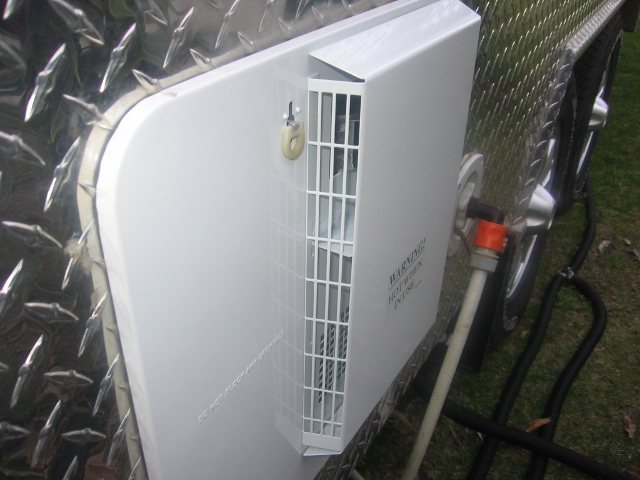

Rod K Posted August 12, 2012 Report Posted August 12, 2012 Hi Richard & CelesteWe had the same dramas with our new water heater.Please see attached pics. This mod fixed the problem and it now lights first time every time.Cheers from the Kyd's.[attachment=1450:IMG_8091.JPG] Quote

sellinup Posted August 17, 2012 Report Posted August 17, 2012 HI RICHARD We have just changed over the hatch to the new modified one ,complements of Coast to COAST ,they also sent a modified flue to allow more air flow, No more problems Regards MAL. Quote
