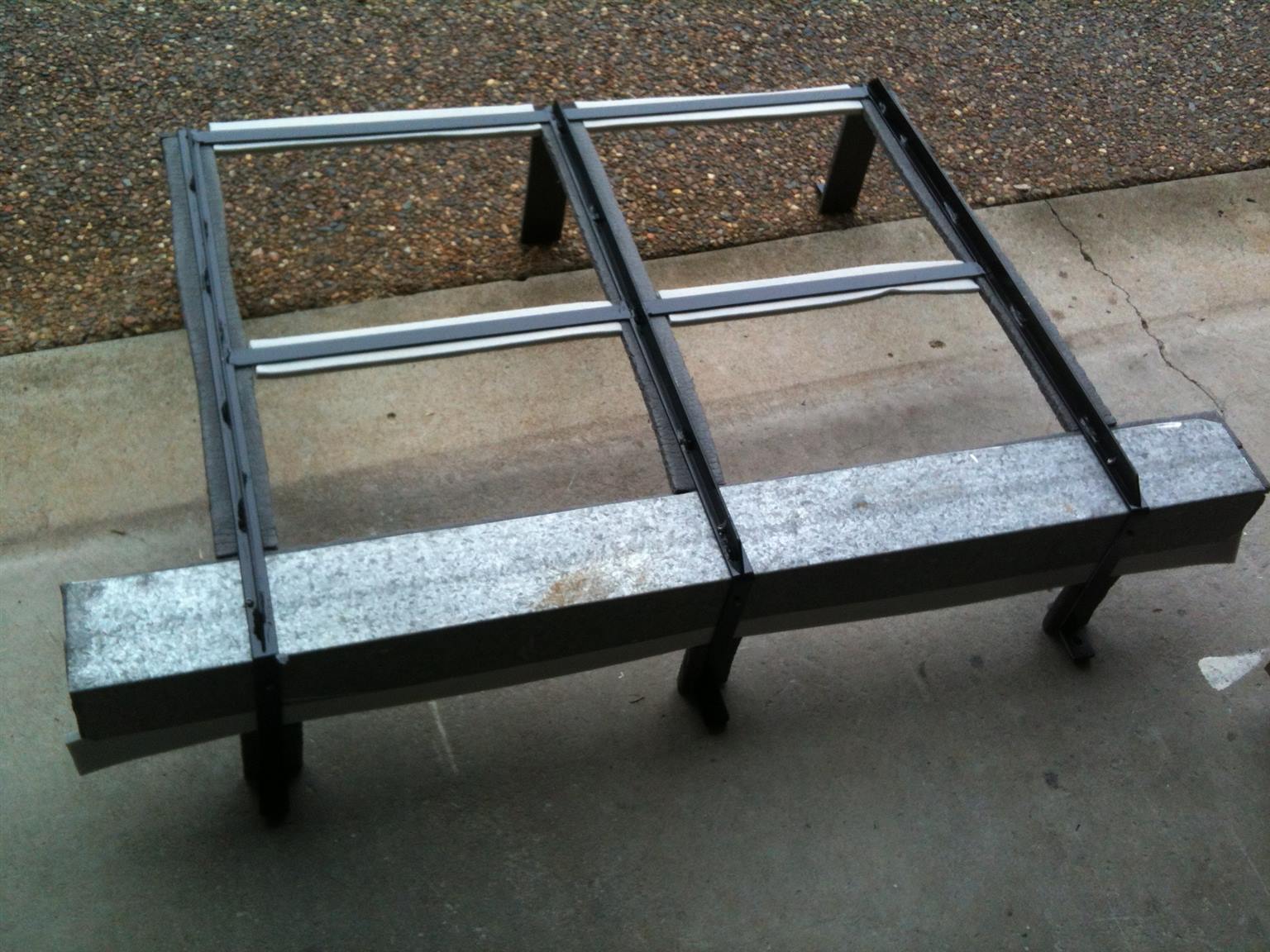

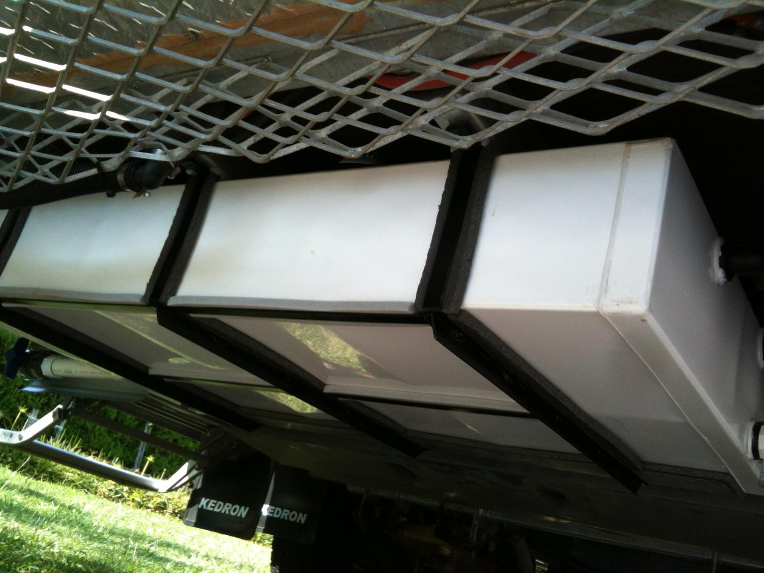

We therefore set about to install an extra tank for storage of grey water. I could not find an off-the-shelf tank to suit my needs, mainly because they did not have inlets and outlets where I wanted them and of the size I required. I therefore had a tank custom made by Abber tanks http://www.abbertanks.com.au/. Their service was very good and the tank appears to be well made.

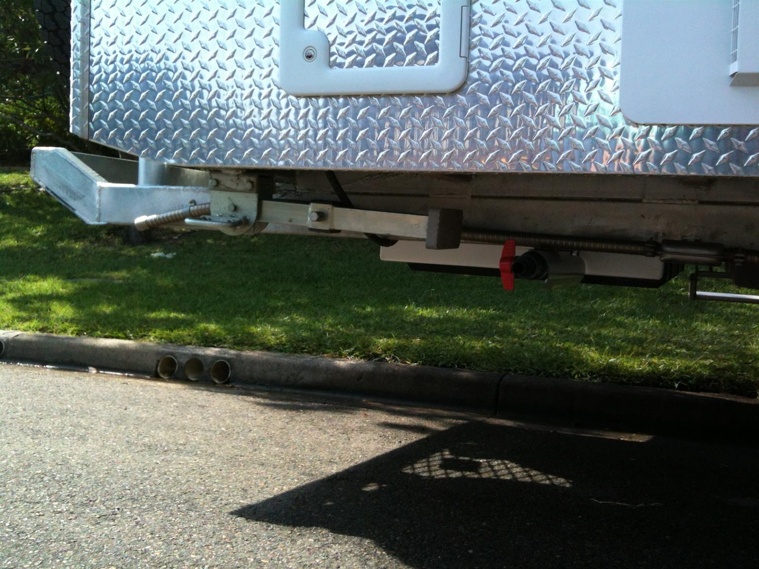

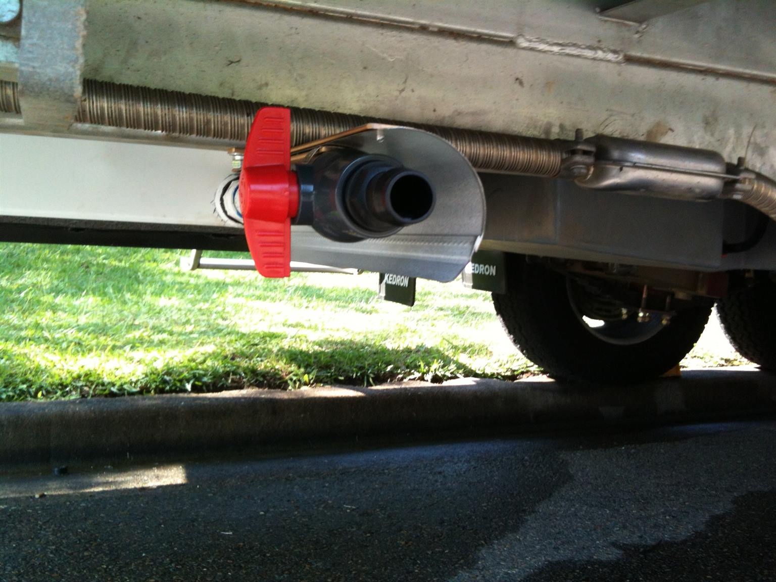

I have separate 1 inch inlets for each of the kitchen sink, washing machine and bathroom, and 2 outlets: 1 inch on the RHS (with a tailpiece for connecting the usual Kedron hose to a park sullage drain) and 1.25 inch on the LHS which might help with quicker dumping of the waste water at the side of the road. These outlets are fitted with plastic ball valves. There is also a 3/4 inch breather/overflow outlet on the top of the tank. No more grappling with the tee piece drain hose supplied by Kedron for connecting the bathroom and kitchen to the sullage drain!

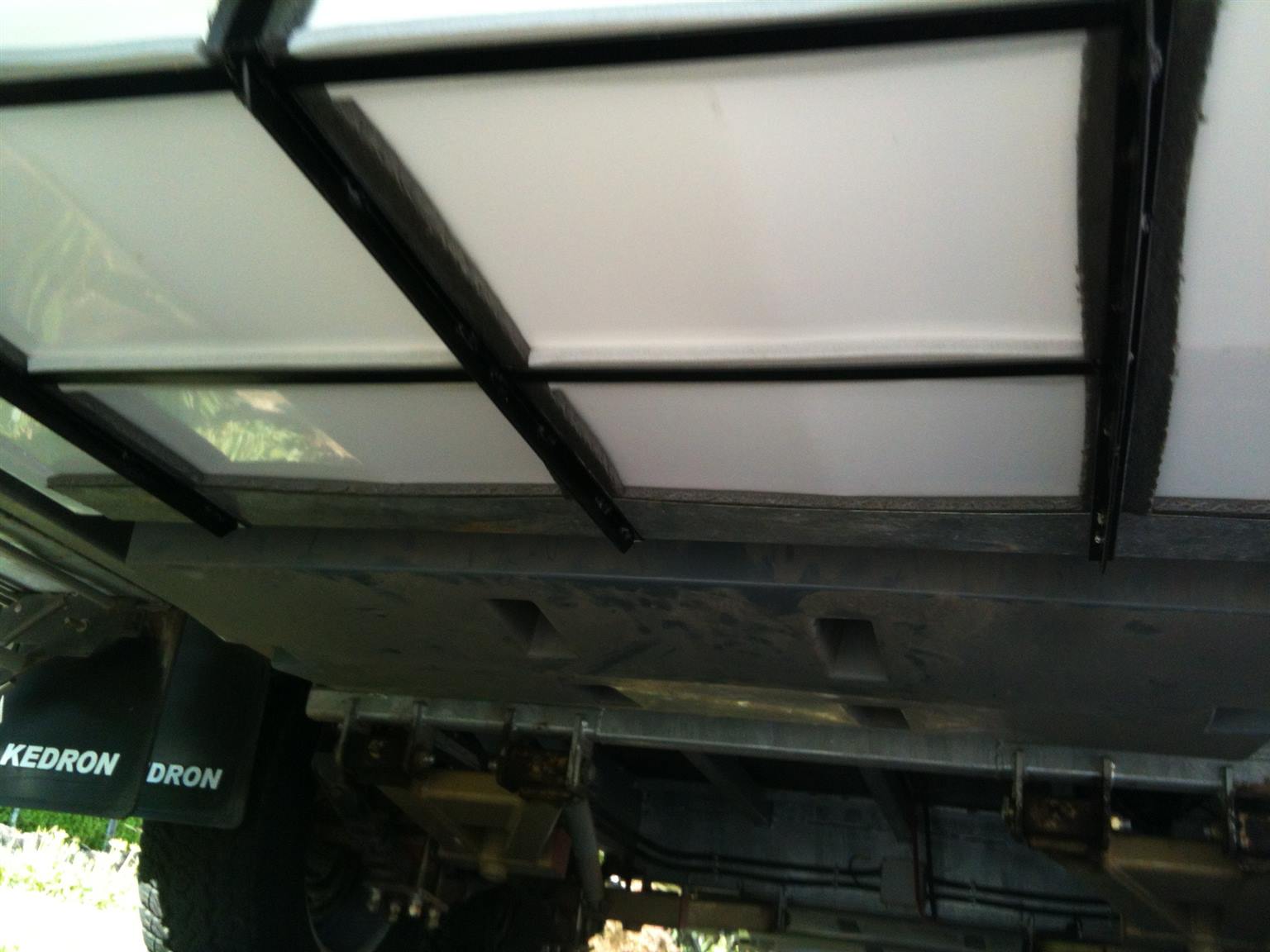

The tank we had made will hold about 125 litres. It weighs just 10kgs and with the holding basket and plumbing the total additional weight is about 15 kgs. There is no additional water weight as it only involves a transfer of water. On our 21 ft Top Ender, I had to move the rear water tank 6 inches forward to make room for the new tank. This was not difficult and required no re-plumbing.

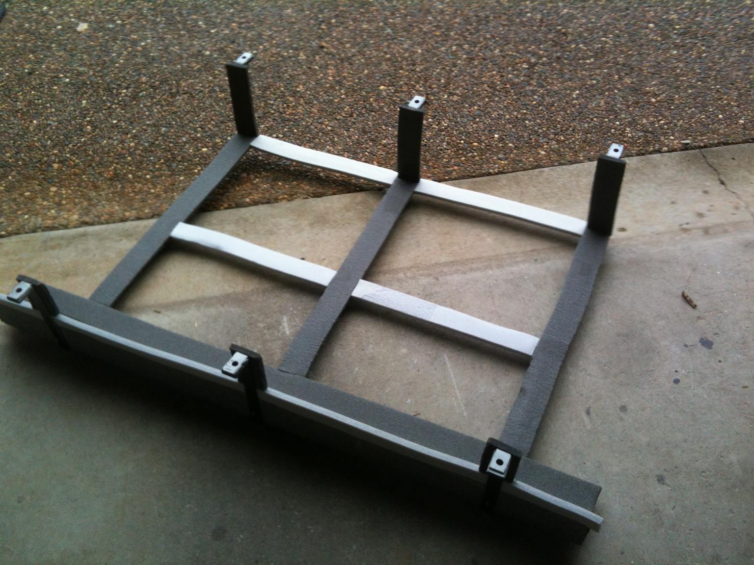

I made up a steel basket to hang the tank in place. The steel used was 19mm x 3mm mild steel flat and I reinforced the 3 bottom bars with a pieces of steel on edge to give it some rigidity - see photos. I also welded some 6mm x 19mm flat to the anchor points of the basket to give them extra strength. The steel basket was lined with foam rubber of the type used for expansion joints in paving - from Bunnings. The stone guard on the front of the basket was made from a split piece of 4" x 3" gal down pipe and the stone guards protecting the ball valves and outlets were made from a piece of circular downpipe from Bunnings. Mounting brackets for the ball valve stone guards were made from 19mm x 3mm flat.
