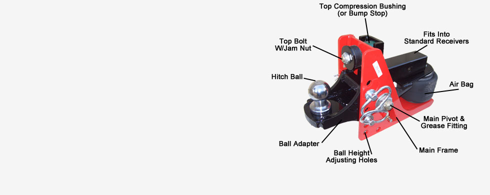

barramundi Posted February 8, 2016 Report Posted February 8, 2016 Hi all, Had the van in for a service where they replaced the floor covering that had moved. Had a chat to Dave and Graham while we were waiting. Have now purchased a shocker hitch connection for the back of the Chev. As I mentioned we found the truck seemed to bounce a bit more than was comfortable. By the way the Chev has airbags and we have put 20 psi in them to help. Did not make much difference. Both of them mentioned that the stiff suspension tended to mask the extra bounce with the stiff suspension from the Chev. As you have seen here there has been at least one cracked chassis with these vehicles. The guy we bought the hitch off pointed out that the robustness of the Chev springs transfers a lot of the pitching onto the van. He even uses them on his goosenecks. By the way he swears by them and would not tow with stiff suspension without them. Do any of the chev/GMC/Ford owners use one of these. Will attach a picture of the hitch for reference. Apart from this the Chev is still an awesome vehicle. Currently at the Sunshine Coast and with a bit of forward planning we have not had any problems with parking. Even managed a spot at Aldi the other day. Love the chev. Doug and lis 1 Quote
Merv and Di Posted February 8, 2016 Report Posted February 8, 2016 Hi Doug I think that hitch is only rated for 3500kgs. You might need one with a little higher rating. You are not running enough pressure in the air bags, should be >30psi and the Chev suspension has nothing to do with cracked chassis particularly with the articulating hitch so you don't have a rigid connection so there is no shock being passed from the truck to the van. Any excuse is better than none to try to pass the buck when it comes to blame. I think the problems with the chassis was more a manufacturing one than the type of tug. cheers Merv 1 Quote

Greg and Cathy Posted February 9, 2016 Report Posted February 9, 2016 Hi All We had problems with wallowing so installed air bags on 2013 Chev. This made it a little too rigid so we bought the air safe hitch which has reduced the shock transfer between the TE and the Chev making the ride extremely comfortable. Quote

barramundi Posted February 9, 2016 Report Posted February 9, 2016 I guess it all boils down to whether you want to be legal or not. Insurance could be a problem if something serious happened. By the way the hitch is rated to 5500 kgs and ball weight of 545 kgs. End of the day we love the Chev and what it does for us. Lets face it if we all liked the same thing it would be a boring old world. The good thing about Aus (at the moment) is we do have a choice. Doug and Lis 3 Quote
